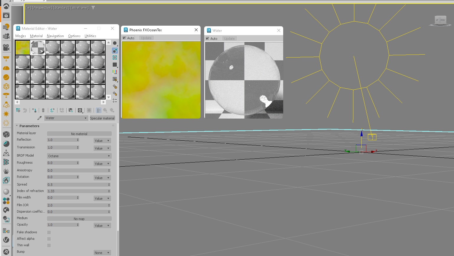

Hello, good evening, I would like to know if someone know how I can use Phoenix FXOcean Tex ?
I mean appear if i select the option Get material but in the option of Octane i can't see this map to create Ocean water, in Corona renderer is more easy create Ocean water whit the Phoenix FXOcean text.
Thank you if someone could help me.
Does anyone know how I can uste Phoenix FXOceanTex ?

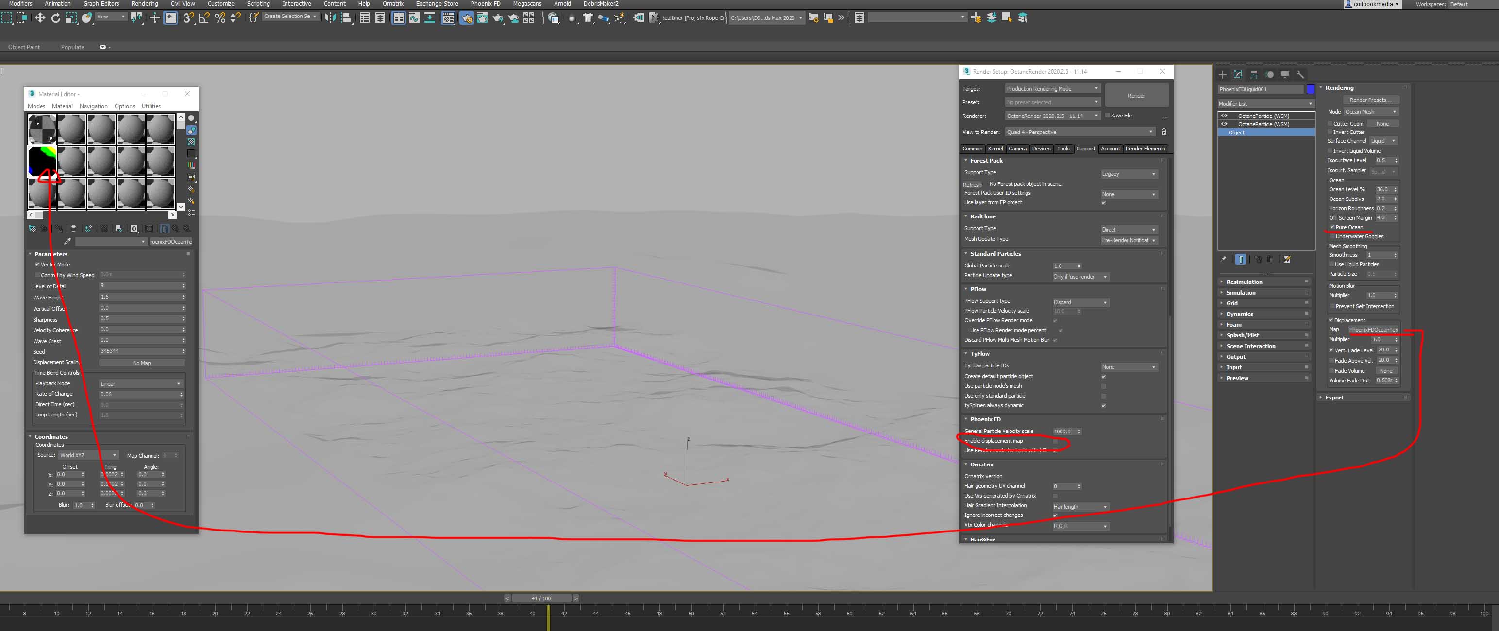

I attached the scene May be it will help. Make sure pure ocean is off if you need to simulate and render boat moving through waves. Also enable displacement map is so phoenix foam will stick on the surface of a displaced ocean.merid888 wrote:Hello, good evening, I would like to know if someone know how I can use Phoenix FXOcean Tex ?
