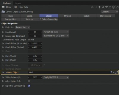

the easiest way is to use a Null or an object in the Focus Object value of the Camera, in Attribute/Object tab:

As Beppe pointed out, there is an option to select an "object" as the "focus target".
Depending on the "aperture" and "lens (camera)" distance to that target, the foreground/background object will be accordingly "blurred" in a physically-plausible way.
