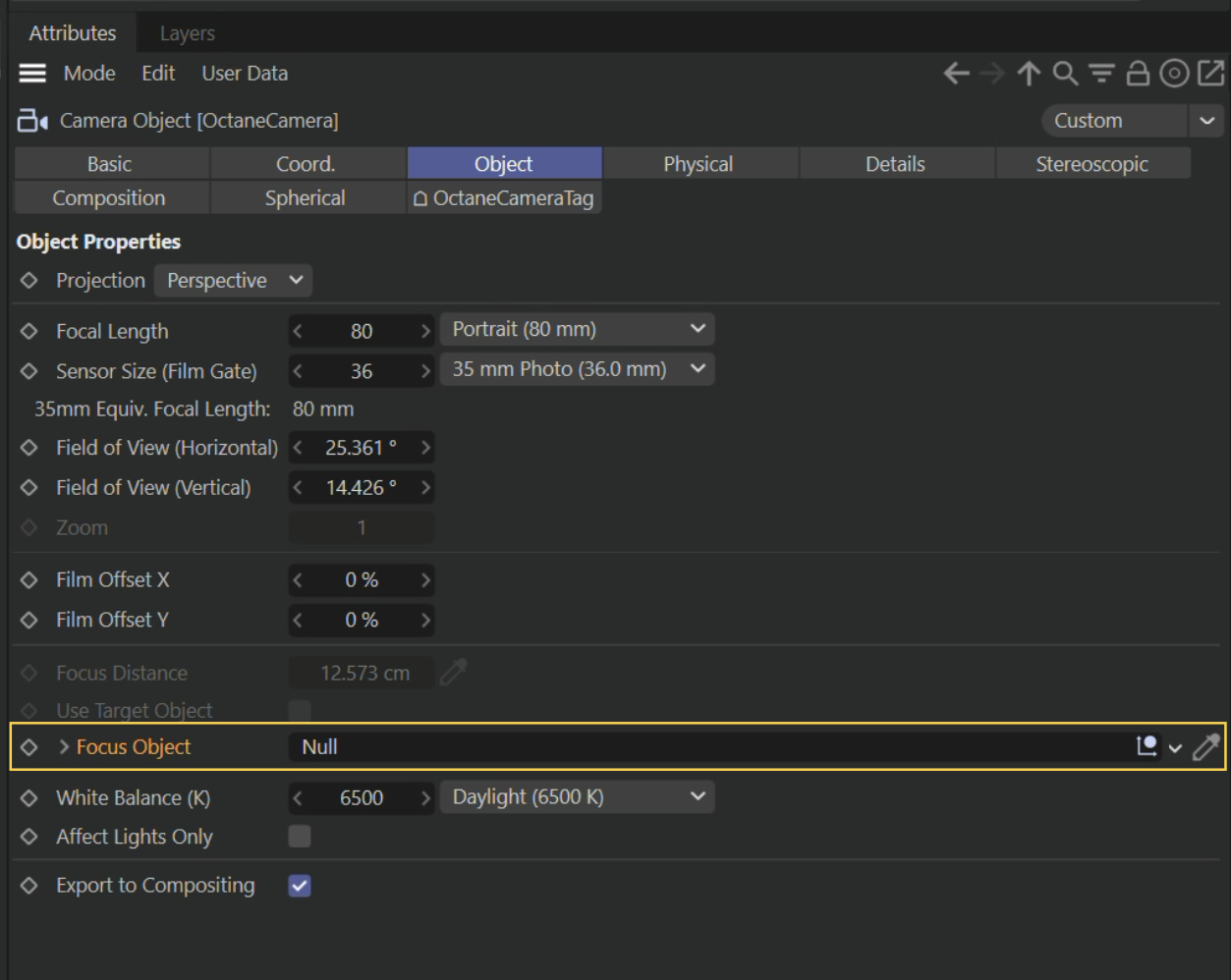

the easiest way is to use a Null or an object in the Focus Object value of the Camera, in Attribute/Object tab:

I know about the focus target but I refer to this:
