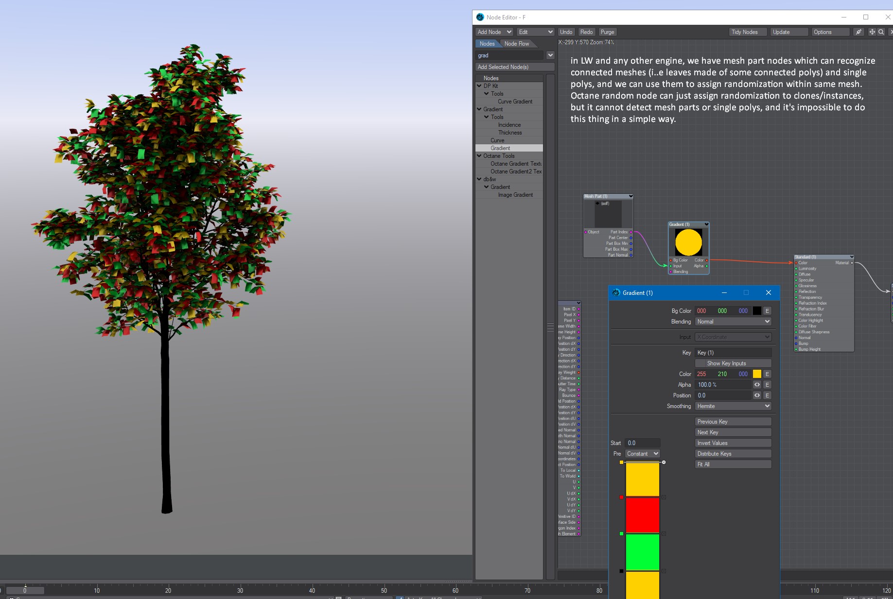

Hi Paride,
hard to tell since these are MAX examples but i'll try to explain.
Imagine a city made of many boxes, all part of the same mesh. I want to assign a different texture to each box (different facades) without having to assign, say, 20 random IDs. In Corona and Vray, the Randomizer can work not only on instances (like Octane Randomizer does) but also on individual elements of a single mesh. This means I can randomize 20 textures on each element of that single mesh without assigning different IDs or creating multiple materials—it's just one object with one material using a "Randomizer by Element" that randomly applies one of 20 textures to each box.
This approach is also very useful in many other situations, such as with trees. For example, you can assign 5 different leaf textures to each leaf (element) using a single material on a single mesh.
Hopefully it's clear, let me know if i've to explain better.

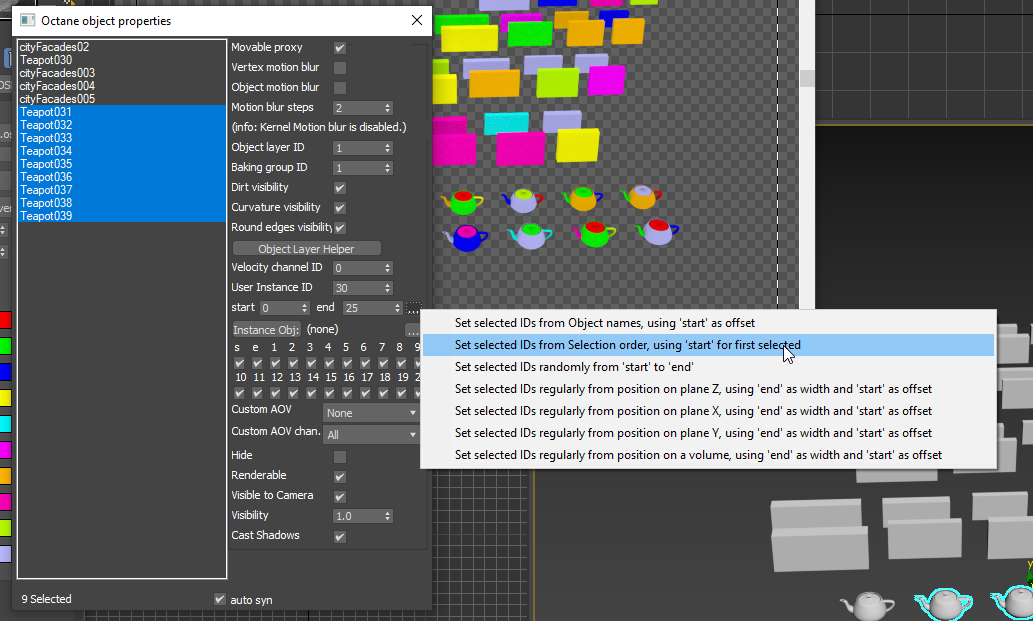

Here is a new OSL texture that select random texture per element.
The objects need to have an Octane geometry modifier, with a Vertex Attributes Generator set as follow:
Generator: PolyConnect
Attribute: Float1
Attribute name: ElementId
The OSL texture rand10Tex_ByElem_obj_uid.osl need to have a Grayscale vertex attribute in the 'Grayscale tex' input.
The Grayscale vertex attribute need to use the same attribute Name as in the geometry modifier : ElementId
Set the Texture count between 1 to 10.
When using multiple instances or copies of the same object, the vertex attribute values will be the same, so the random pattern will also be the same for each instance.
To have random variation on those instances, enable the 'Use Object seed' and / or 'Use InstanceID seed'
'Use Object seed' add randomness from an internal unique ID per object, but those IDs could change as you add/remove objects in the scene.
'Use InstanceID seed' add randomness from the 'User instance ID' that can be set per object in the Octane Object properties dialog.
Those Instance IDs will not change, so the random pattern will be more stable.
Note that you can use the tools in the Octane Object properties dialog to set those User instance IDs for all selected objects. The second OSL (rand20Tex_ByElem_obj_uid.osl) is the same, but with up to 20 textures.
