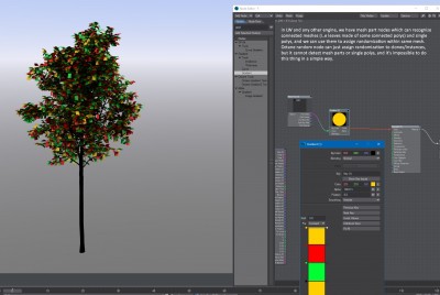

Just for clarity, this is same thing in Lightwave - single mesh, but different colors (or maps) for each leaf using an element-aware randmizer.
best
Paolo

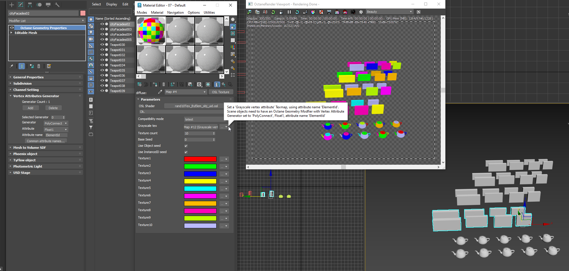

Here is a new OSL texture that select random texture per element.
random tex per element.zip
(348.92 KiB) Downloaded 92 times
The objects need to have an Octane geometry modifier, with a Vertex Attributes Generator set as follow:
Generator: PolyConnect
Attribute: Float1
Attribute name: ElementId
The OSL texture rand10Tex_ByElem_obj_uid.osl need to have a Grayscale vertex attribute in the 'Grayscale tex' input.
The Grayscale vertex attribute need to use the same attribute Name as in the geometry modifier : ElementId
Set the Texture count between 1 to 10.

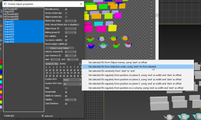

When using multiple instances or copies of the same object, the vertex attribute values will be the same, so the random pattern will also be the same for each instance.
To have random variation on those instances, enable the 'Use Object seed' and / or 'Use InstanceID seed'
'Use Object seed' add randomness from an internal unique ID per object, but those IDs could change as you add/remove objects in the scene.
'Use InstanceID seed' add randomness from the 'User instance ID' that can be set per object in the Octane Object properties dialog.
Those Instance IDs will not change, so the random pattern will be more stable.
Note that you can use the tools in the Octane Object properties dialog to set those User instance IDs for all selected objects.
