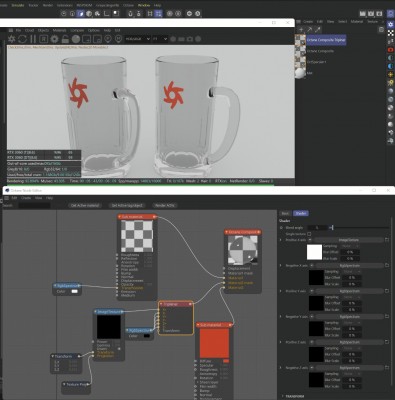

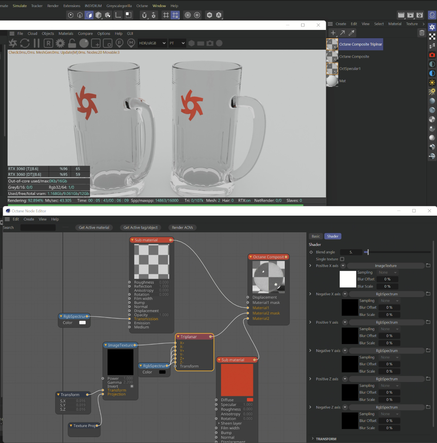

you can use the Triplanar node, with the logo (with Triplanar projection) on one axis and a black color in all the other axis pins:

Or, select the polygons where the texture should appear, then under the c4d select menu run the "Store selection" command ("set selection" in older c4d versions). You should notice a small triangle tag appear next to your object in the object manager. Select the material tag on your model, the drag the triangle tag into the "selection" parameter.

Thank you so much guys, really appreciate the screenshots too, very helpful. Problem solved! Have a great weekend.
