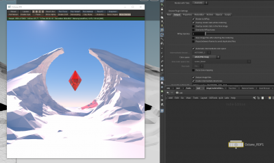

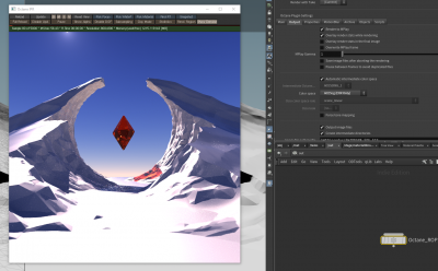

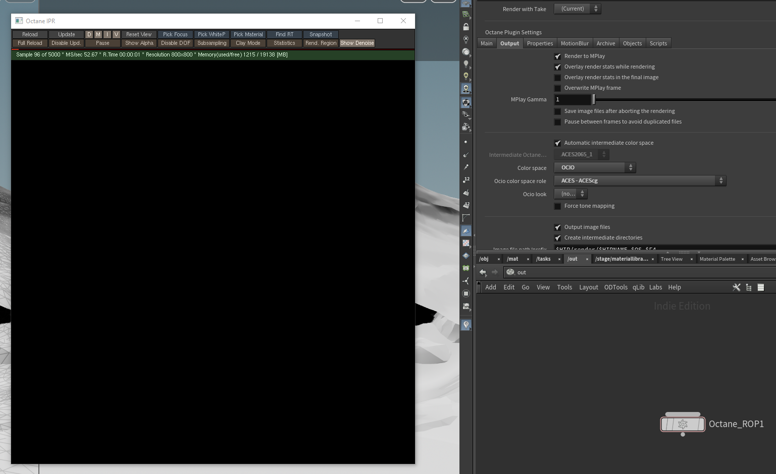

The ipr on everything but srgb is way off. And when I set it to OCIO the screen goes completely black.

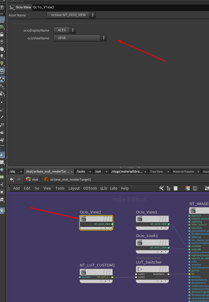

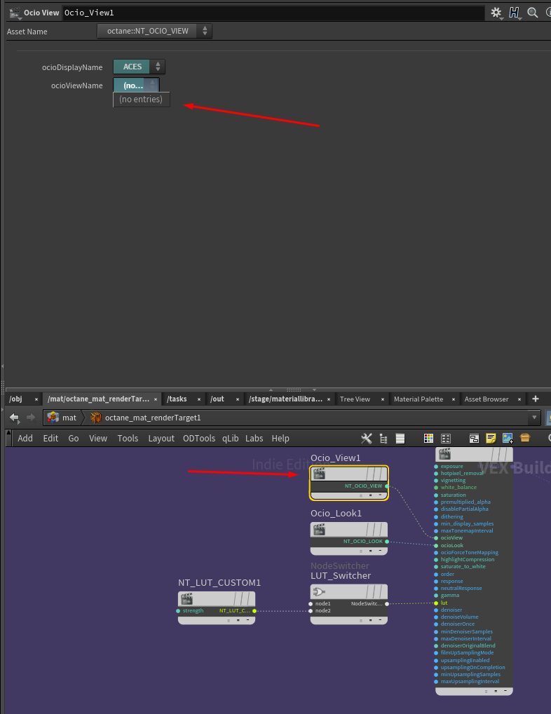

I figured out that the issue stems from the ocio_view node that comes in the render target by default does not show any available views. If I drop down a fresh one from the tab menu or reset the one that comes with it to defaults on the other hand all the views show.
Once I plugin my custom ocio view node the ipr now looks correct. I do not know why this is happening but it's very frustrating.
