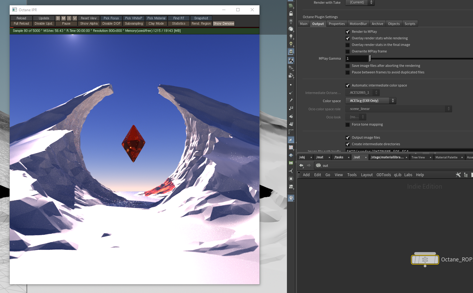

I am having a bunch of issues with OCIO in octane (and octane only). I figured it would be better if I outlined everything here. These are all issues that I did not have a few months ago.
First things first I'm on Houdini 19.5.303 and Octane 2021.1.1.5.0 on Windows 10. My OCIO config file is declared in the houdini.env file and I am using aces_1.2.
Issue 1:
The ipr on everything but srgb is way off. And when I set it to OCIO the screen goes completely black.
I figured out that the issue stems from the ocio_view node that comes in the render target by default does not show any available views. If I drop down a fresh one from the tab menu or reset the one that comes with it to defaults on the other hand all the views show.
Once I plugin my custom ocio view node the ipr now looks correct. I do not know why this is happening but it's very frustrating.

You probably have the answer to the OCIO issue in the last topic you have attached: The OCIO settings for the IPR are available in the RenderTarget /mat HDA, in the Imager tab. Be aware that you need to select the ocio display name (for example "ACES") even if it is the default option to let the HDA populate the views drop-down menu.
I know that this is a weird behavior, but I've not found how to auto-populate the views menu without selecting any display first. I'm still investigating how to build a startup script to do that.

Yeah that fixed it.
Could a simple python onCreated script fix the issue maybe?
With this it's working:
Is there any scenario where the display name should not be ACES or at least by default?
Code: Select all
node = kwargs
thisnode = node['node']
thisnode.parm("A_OCIO_DISPLAY_NAME").set("ACES")- HandcraftedMedia
- Posts: 72
- Joined: Thu Jan 10, 2019 12:15 am
Sweet.
I noticed for it to work it also needs to include the view name as well so:
Code: Select all
node = kwargs
thisnode.parm("A_OCIO_VIEW_NAME").set("sRGB")
