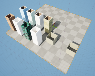

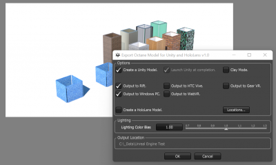

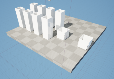

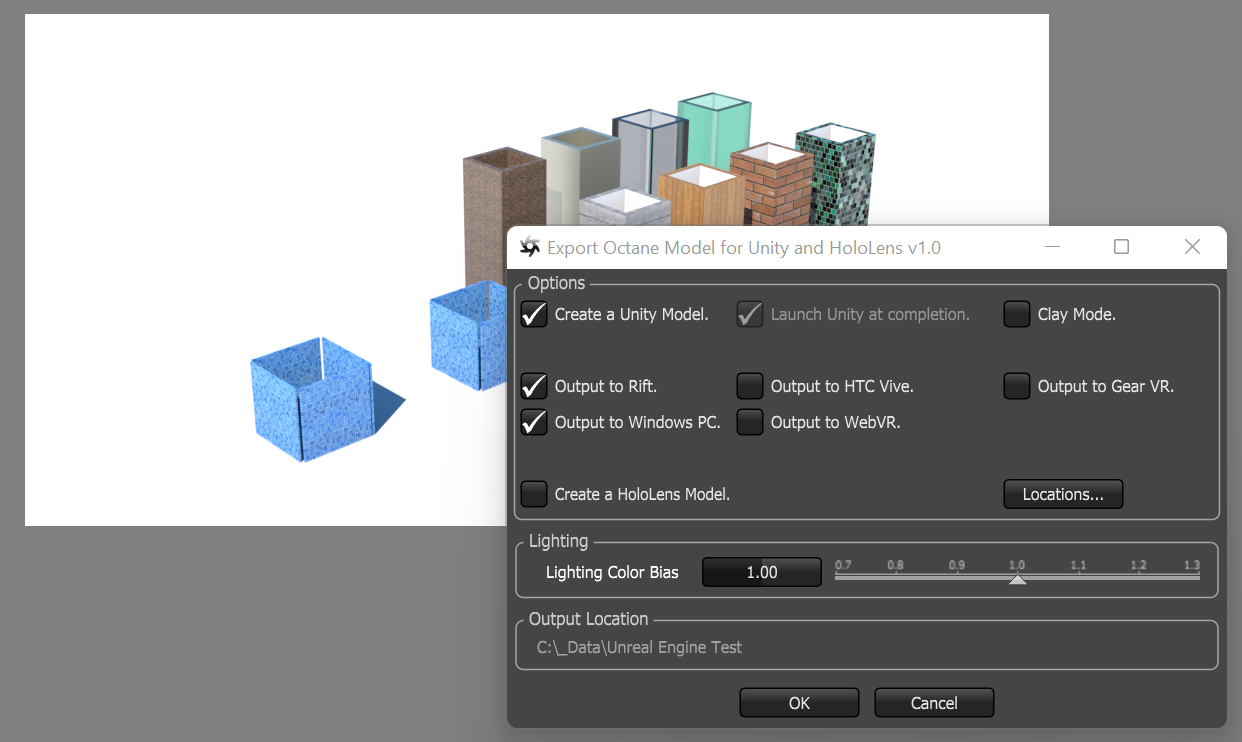

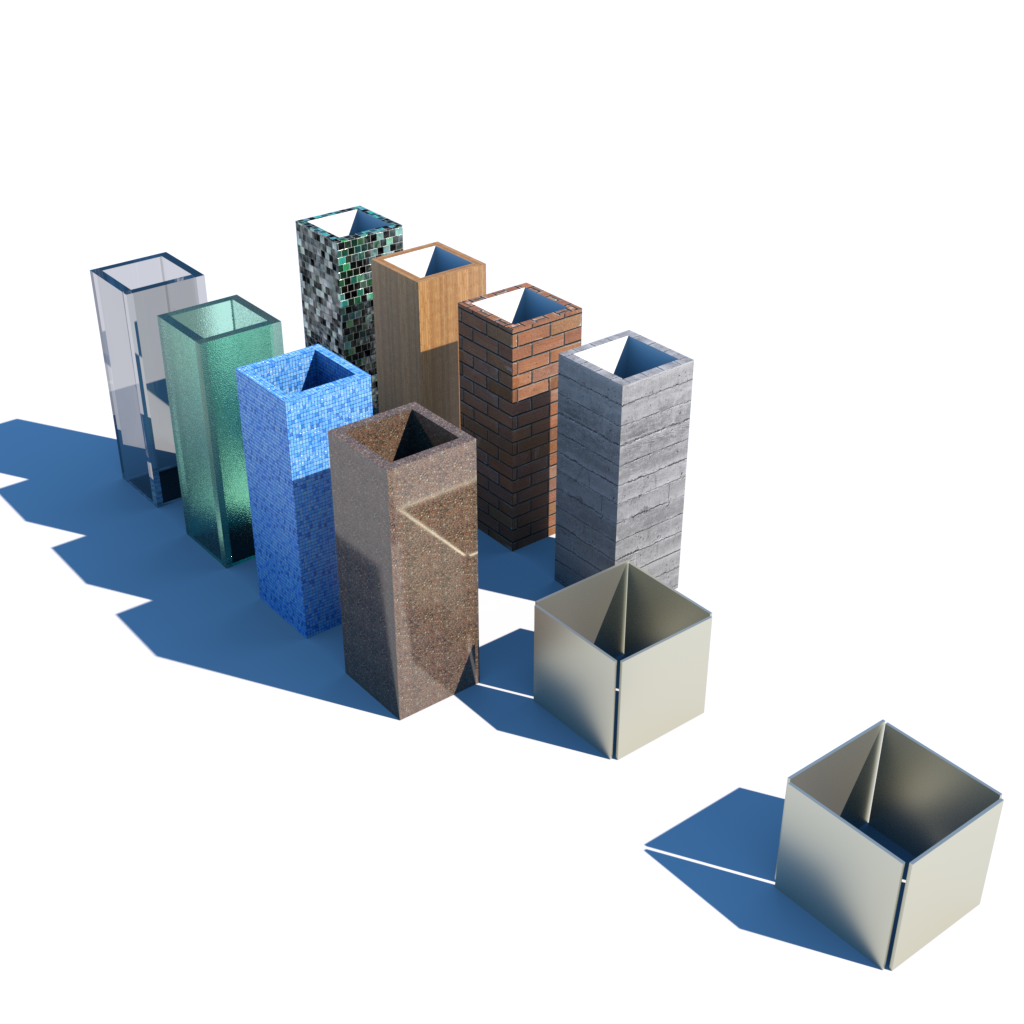

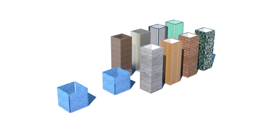

following image is an orbx created from an obj with groups utilized as in snippet above
file rendered from octane standalone following image is exported from UE5 after importing the above orbx:
Note that transparent materials are no longer transparent, wood and granite textures were lost, and what material go applied to what column has been shuffled, e.g., brick has moved from third column in top row to first column in bottom row. Note that if groups were not utilized in the original obj file, all elements in the scene would have received the same material. following image is exported from UE5 after importing the above orbx:
in this case the orbx was created from an obj with without utilizing groups I have not implemented Object [0] and tested the impact of that record on your import code. Clearly your code (or is it epics code) reacts to the presence of g, what's odd is that it affects the application of the usemtl. g itself is nothing more than a text attribute applied to the subsequent faces until it is eventually changed. I Octane Standalone, if present, it will implement the Object Layers feature and it works beautifully. This (and the unit's issue) leads me to believe you are using UE's code to parse the obj file, not yours.

I fixed the following issues. The fixes will be part of the next build.
1. Material are now always connected to the correct slots for OBJ meshes
2. Meshes with different unit scales (millimeter, feet, poser units, meter, etc) are now correctly scaled when imported.
I could not fix the issue where unreal does not create material slots because the underlying OBJ file lacks groups.
This seems to be an issue with the OBJ importer with unreal, as it refuses to create material slots for each usemtl section and only looks at groups.

Chris, I have downloaded the latest build. The new scaling of orbx on import works great, no more getting lost in space. Thankyou.
I still have some issues with material mapping, non-texture map-based materials in particular. Things like procedural Glass, Metal. All materials with maps came across fine with good fidelity to the Octane original material. All others did not.
So is this user error, a known issue being worked on, or a bug.
in each case I was able to create a new UE5 material with good fidelity, so it looks like it is possible to map from one to the other.
If need be, I can document more thoroughly with illustrations.
Windows 11, 2x Intel I9, 64GB Ram, 2x GTX 1080 TI, 1 x RTX 380 TI, Oculus Quest 2
