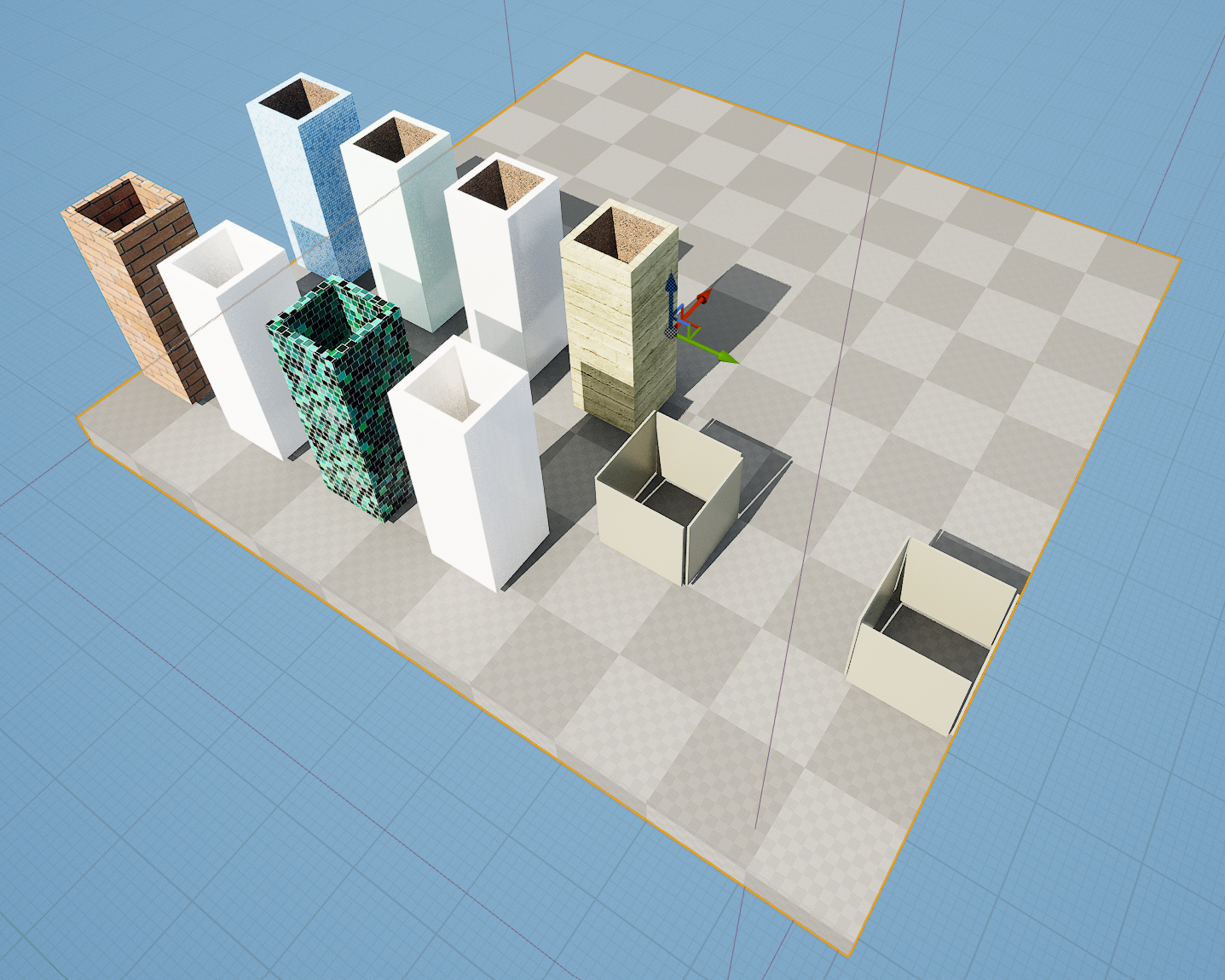

following image is an orbx created from an obj with groups utilized as in snippet above
file rendered from octane standalone
following image is exported from UE5 after importing the above orbx:
Note that transparent materials are no longer transparent, wood and granite textures were lost, and what material go applied to what column has been shuffled, e.g., brick has moved from third column in top row to first column in bottom row. Note that if groups were not utilized in the original obj file, all elements in the scene would have received the same material.

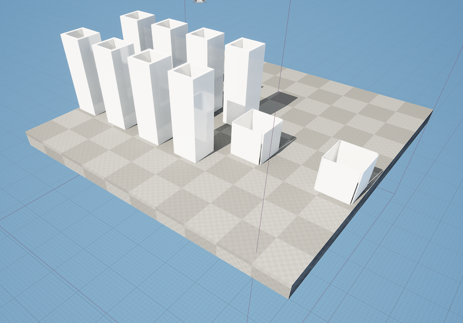

in this case the orbx was created from an obj with without utilizing groups

Chris, I have downloaded the latest build. The new scaling of orbx on import works great, no more getting lost in space. Thankyou.
I still have some issues with material mapping, non-texture map-based materials in particular. Things like procedural Glass, Metal. All materials with maps came across fine with good fidelity to the Octane original material. All others did not.
So is this user error, a known issue being worked on, or a bug.
in each case I was able to create a new UE5 material with good fidelity, so it looks like it is possible to map from one to the other.
If need be, I can document more thoroughly with illustrations.

MB wrote:Chris, I have downloaded the latest build. The new scaling of orbx on import works great, no more getting lost in space. Thankyou.
The octane-> conversion was never meant to have high fidelity.
But ill check what i can add if you give me illustrations.

Chris,
Here is a document detailing what I have encountered in the current mapping of octane materials to UE5.
Good news is it is not difficult to get a fairly faithful reproduction inside of UE.
I hope it helps, let me know if you have more questions
