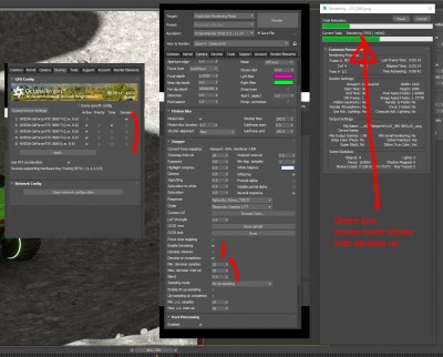

Hi Paride,
Currently I use 512.15 Separate card is dedicated to denoising. here are my settings. They are default. All GPUs are 3080TI old GPUs had same problem with speed.
Should I increase max denosier interval?
Like this scene denoiser on 56 sec, OFF - 25 seconds
