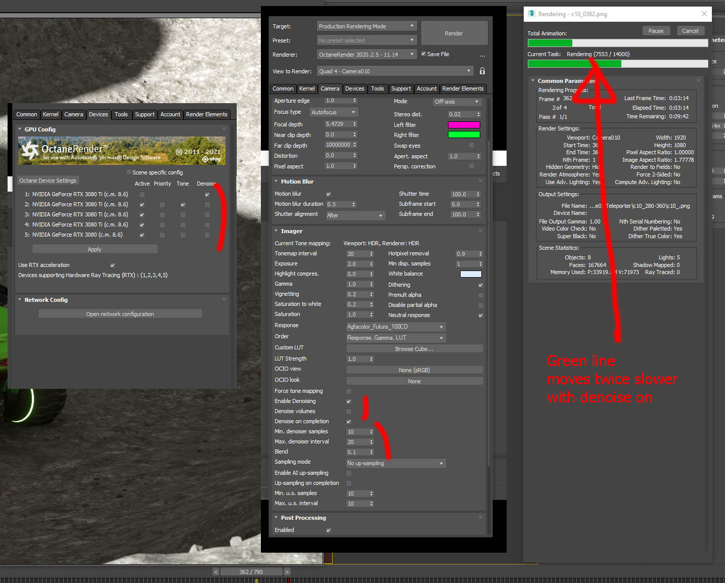

When we enable to denoise at the end, the overall rendering gets twice slower. So instead of 0:40 (denoise OFF) it takes 1:20 (denoise on).
Denoise itself only takes 3-5 seconds at the end but why the overall rendering is twice slower? Then there is no point for denoising I can just render a bit longer and get cleaner image. Thanks

Hi Paride,
Currently I use 512.15 Separate card is dedicated to denoising. here are my settings. They are default. All GPUs are 3080TI old GPUs had same problem with speed.
Should I increase max denosier interval?
Like this scene denoiser on 56 sec, OFF - 25 seconds
Here is another post where they have the same problem viewtopic.php?f=23&t=74086&p=378707&hil ... al#p378707
It does appear it renders slower since denoiser was first introduced. About 2 -2.5 times slower. I wonder if denoise on completion check box does nothing and it denoises during rendering.
