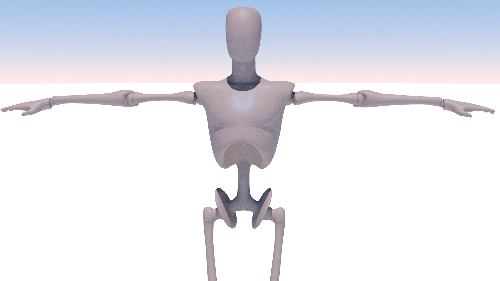

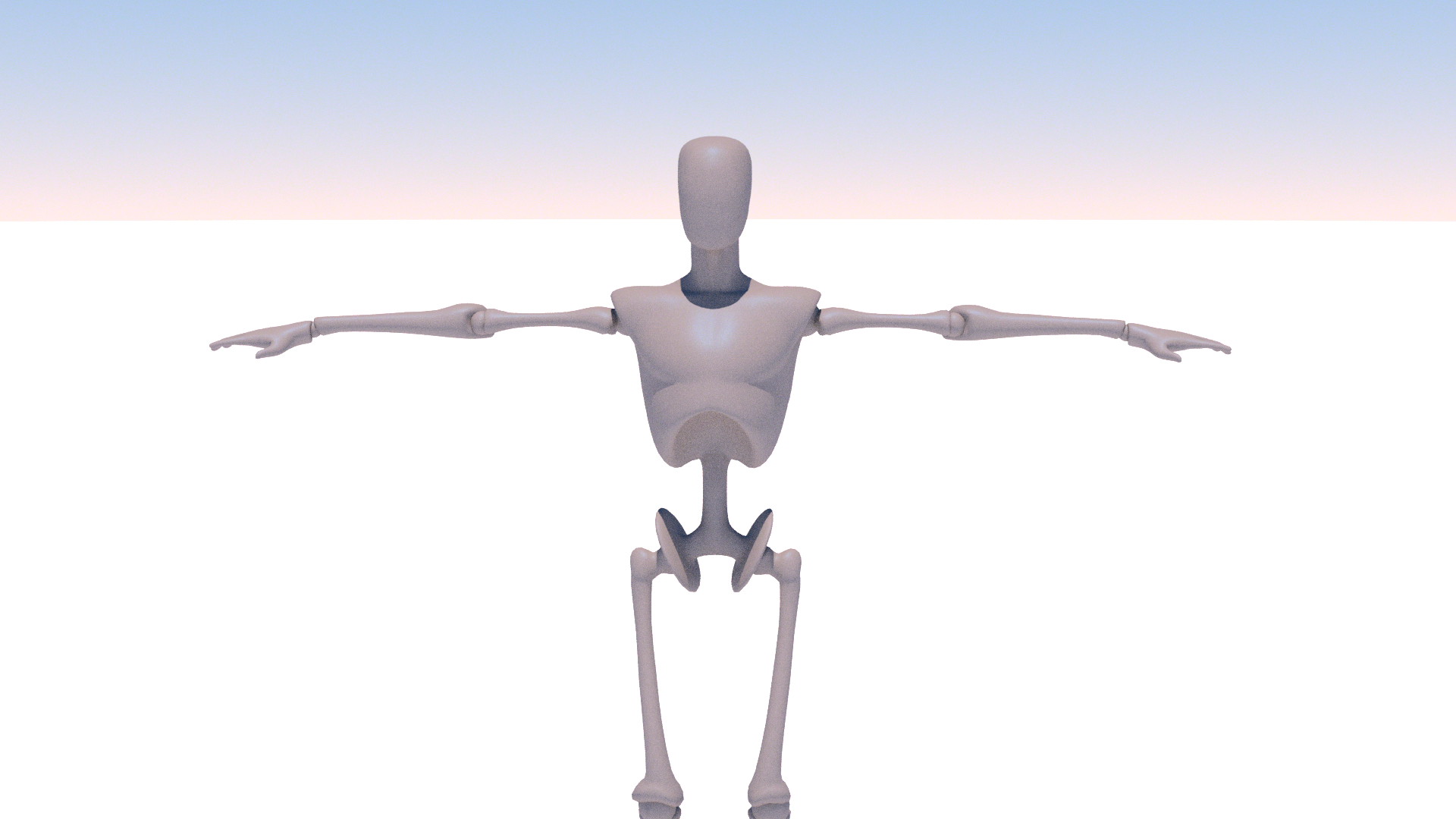

I'm putting this here because I think it's part of the same issue.
After further testing, I found out that the Dolly cam is a bit zoomed out in the standalone., when I export the animation.
The main camera it's fine. Is this a poser bug that will not be resolved anytime soon? Just asking because I use the dolly cam to animate a lot. I find it more user-friendly than the main camera.
The Bottom is poser and the top is Octane.
