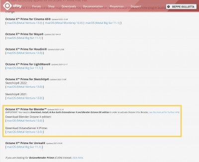

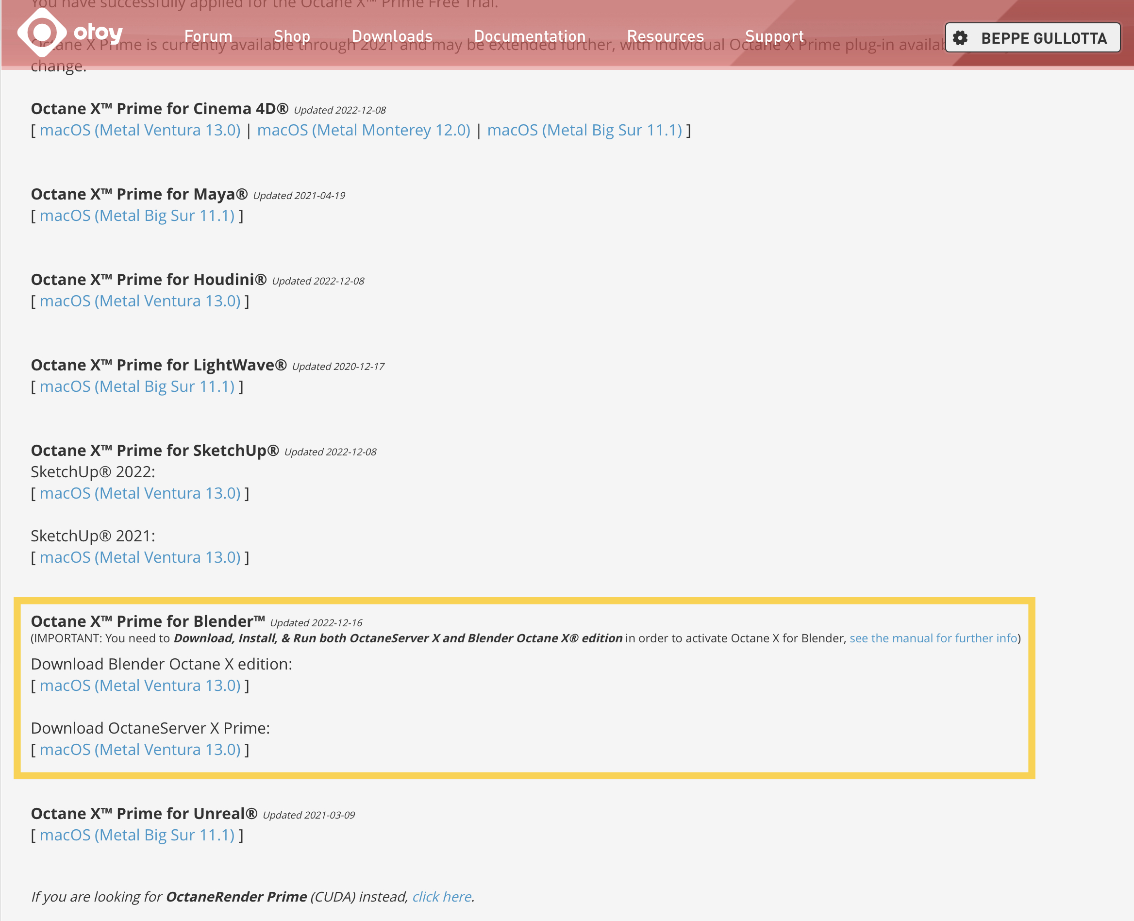

Blender OctaneX Prime for macOS 13 Ventura native for M1/M2 chip is available in the Free Prime OctaneX page here:
https://render.otoy.com/shop/primex.php?
Or directly in the Blender Release discussion:
viewtopic.php?f=113&t=81074
Happy Mac GPU rendering!
