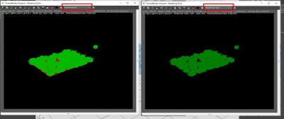

Here is a simple scene :
- a plane with Render Layer ID 1
- a teapot with ID 2
- a Forest Pack object with ID 2
I would like to have Fp object in green in the Render Layer id pass.... but no.
RENDER layer ID 001.zip
(54.28 KiB) Downloaded 140 times

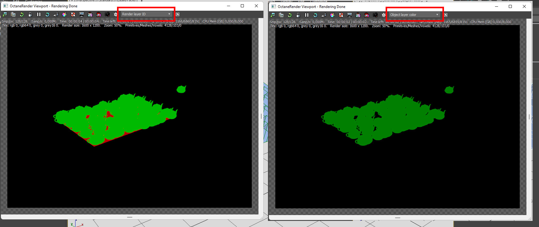

Is there any chance you you are using object layer color instead of Render layer ID?
Regards
Paride
HHbomb
Posts: 1438

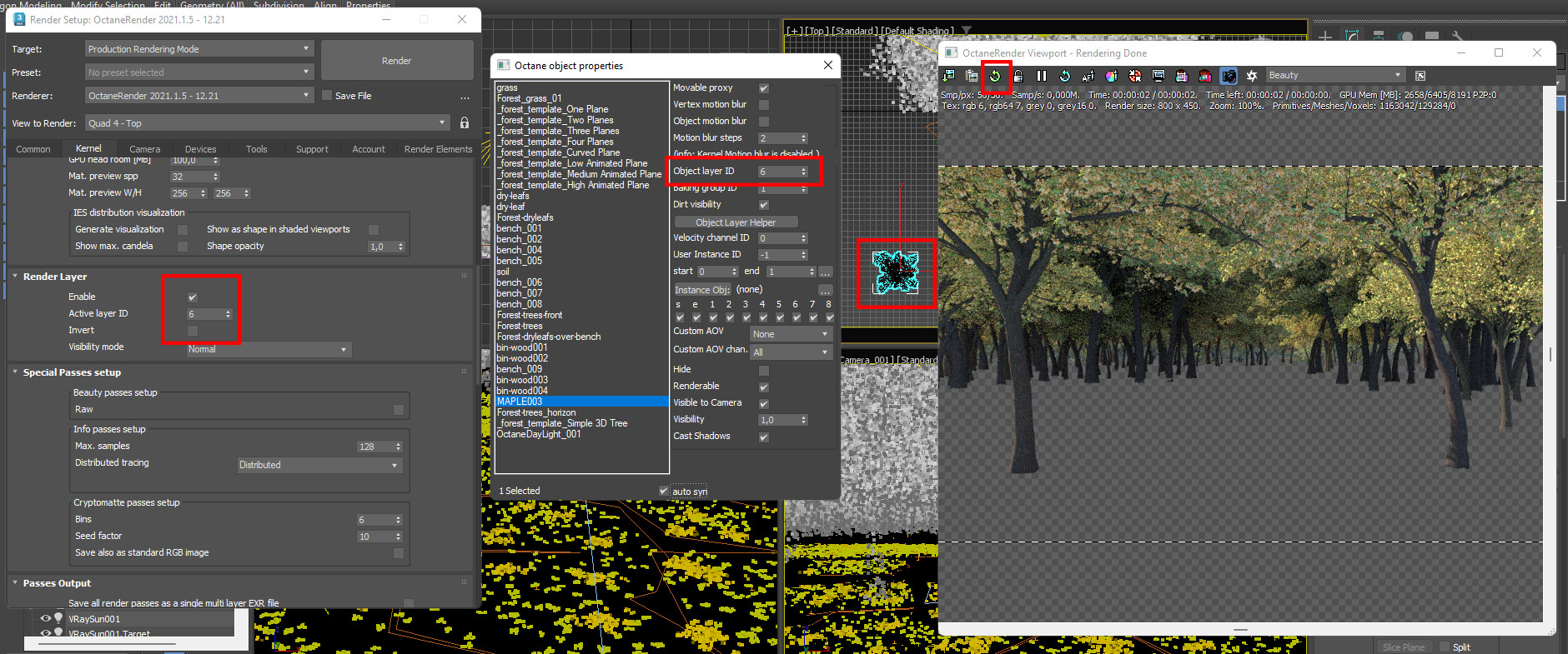

Hi, I use lastest octane render version now (2021.1.5_-_12.22) and if I want to change Render layer ID of forest pack objects , I need to change RL ID of Forest Pack object itself ( not its objects in Geometry tab )

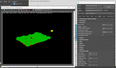

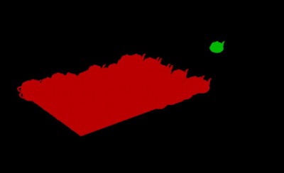

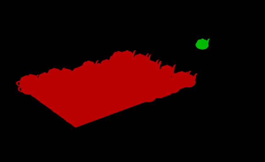

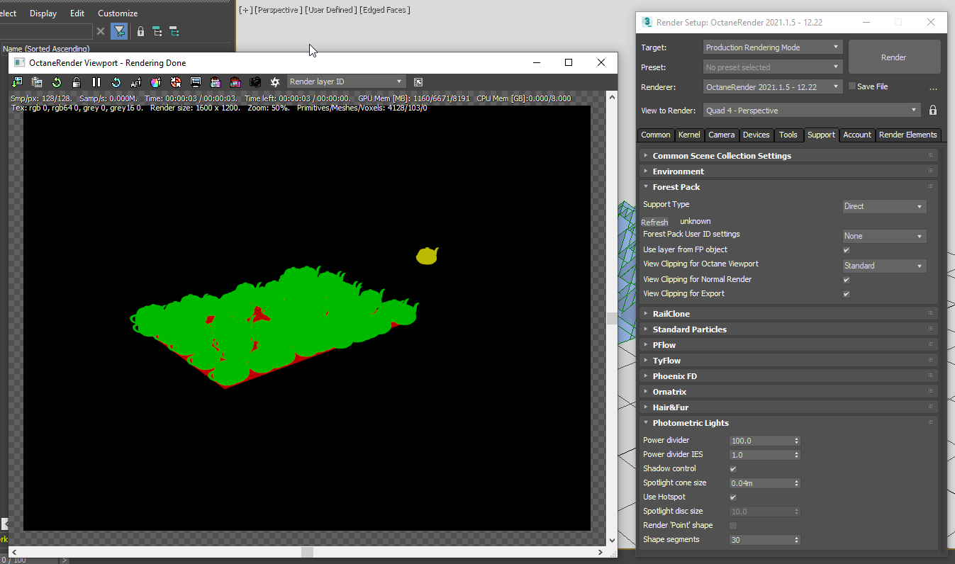

Your scene works fine for me too; I get the FP teapots in green, layer ID 2..
Could you try this scene :
RLayerID_2_passRLid.zip
(60.76 KiB) Downloaded 117 times
I just added the Render layer ID pass, and set the teapot layer ID to 3
If you just open the Octane viewport and set the current pass to Render layer ID, you should get this:
Note that in Render settings / Support / Forest pack, the 'Use layer from FP object' is enabled, so it will use the layer ID from Forest001 (layer ID 2).
You could try to disable it, to check that it takes the ID from the referenced object as expected (Teapot001, layer ID 3)
The issue could come from some of the Octane Preference settings, but I couldn't find one that would do this..
Could you try Preferences / menu Preset : Reset Default settings ?
I tested with Forest pack 6.3.1 and 7.4.1.. what version do you use ?
