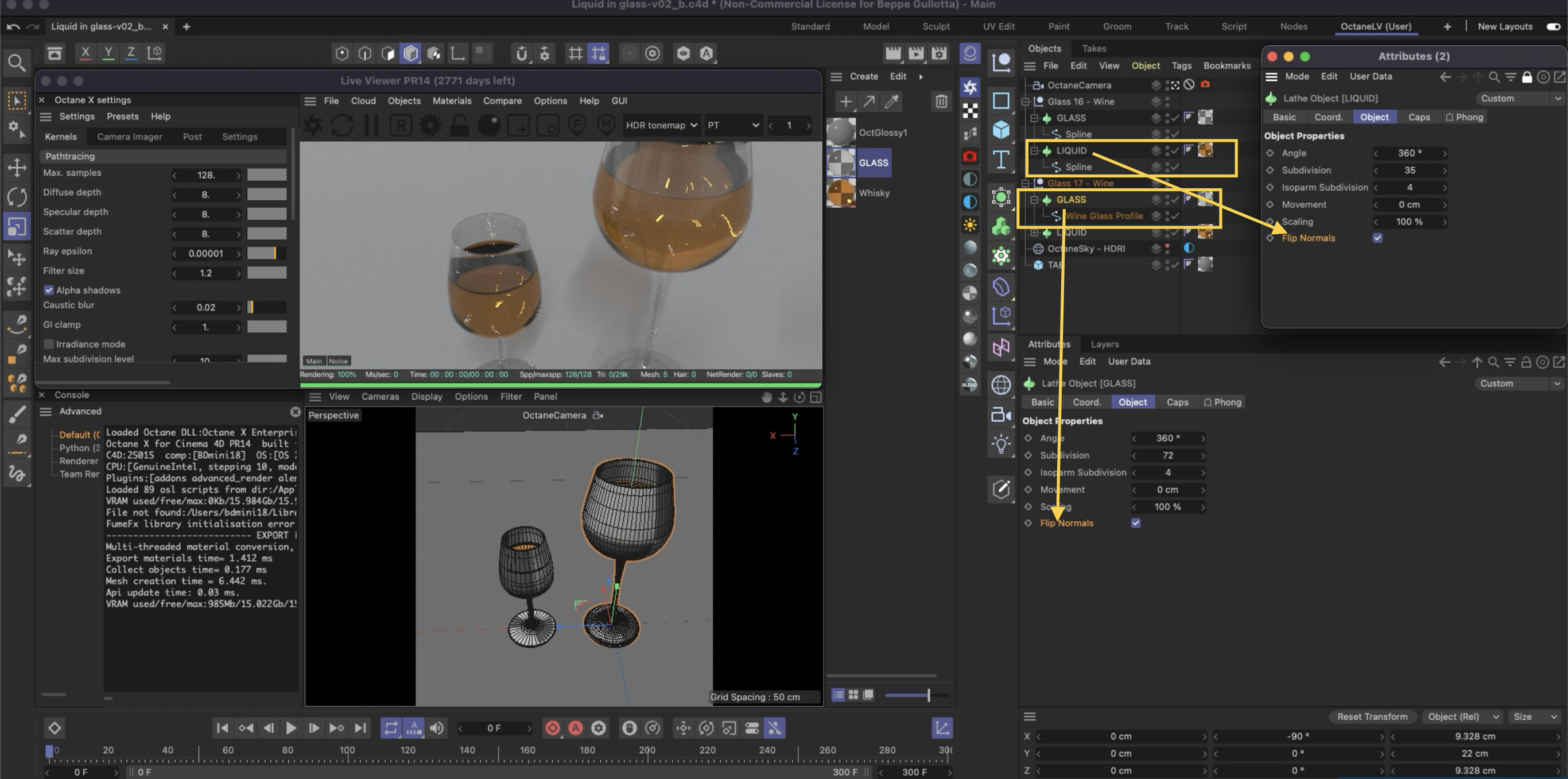

About the scene, the issue is caused by the Normal direction, in one case it is the Glass, and in the other is the Liquid that needs to flip the normals: ciao,
Beppe
