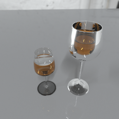

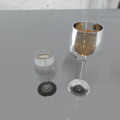

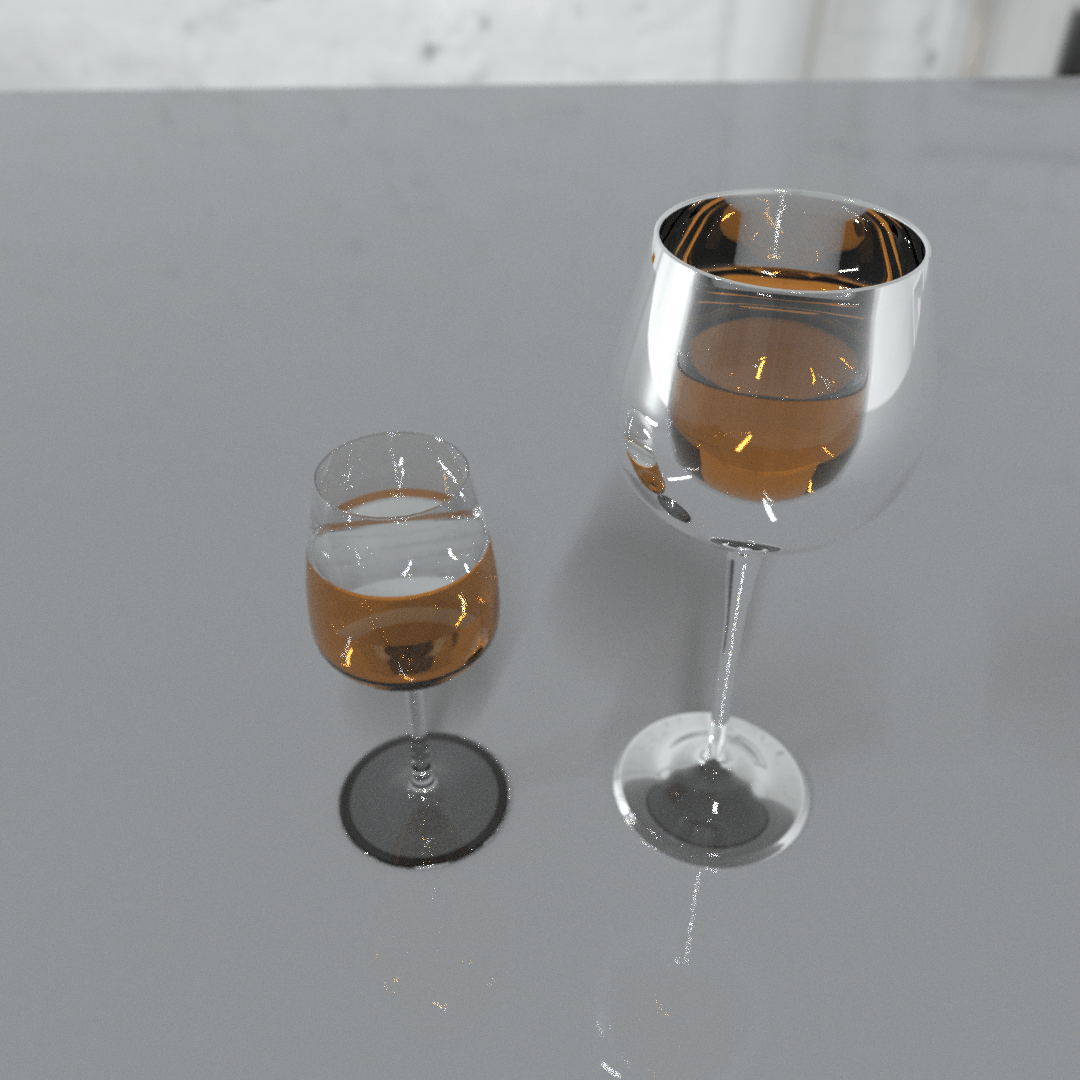

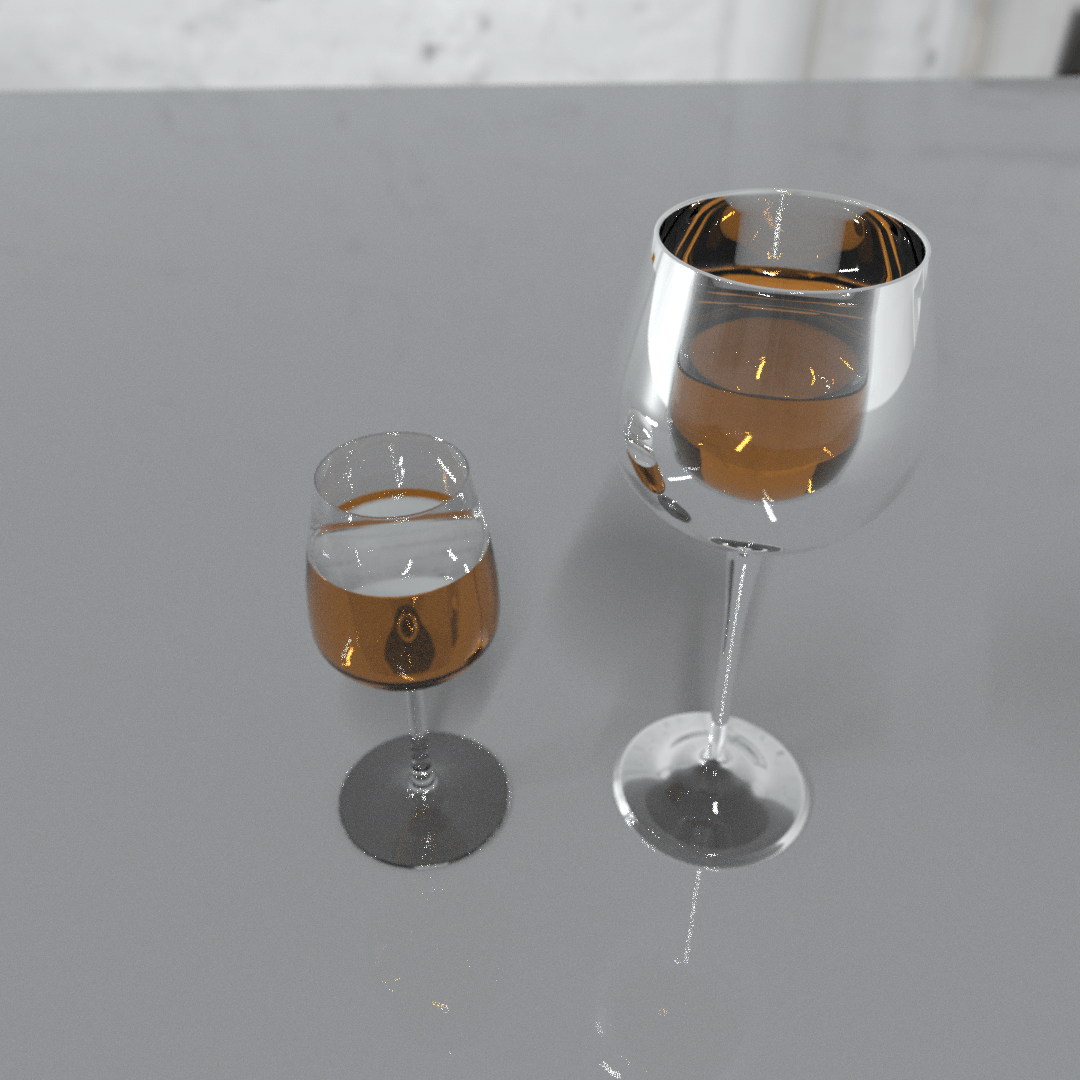

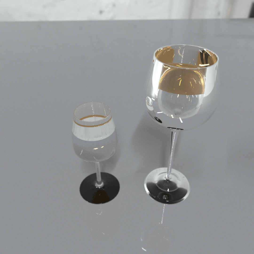

Trying to produce a simple glass of whisky. I've used a couple of C4D library assets with a whisky material from LiveDB and Specular for the glass with 1.52 index. Surprised how different and how incorrect they look.
Another thing that confused me was the vast difference when adjusting the Ray epsilon. (attached 0.00001 to 0.01) The glasses are to scale.
I found this thread which experiments with the liquid overlapping the glass, but I don't think that is the problem
I'm using Pathtracing. Is there somewhere I'm going wrong?
ray epsilon 0.00001
ray epsilon 0.00001
ray epsilon 0.0001
ray epsilon 0.0001
ray epsilon 0.001
ray epsilon 0.001
ray epsilon 0.01
ray epsilon 0.01

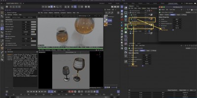

About the scene, the issue is caused by the Normal direction, in one case it is the Glass, and in the other is the Liquid that needs to flip the normals:
Liquid in glass-v02_b.c4d.zip
(93.09 KiB) Downloaded 101 times
ciao,
Beppe

Thanks Beppe. I realised it matters which side the spline is on in the Lathe object, that dictates where it's normals are, I don't use Lathe much
