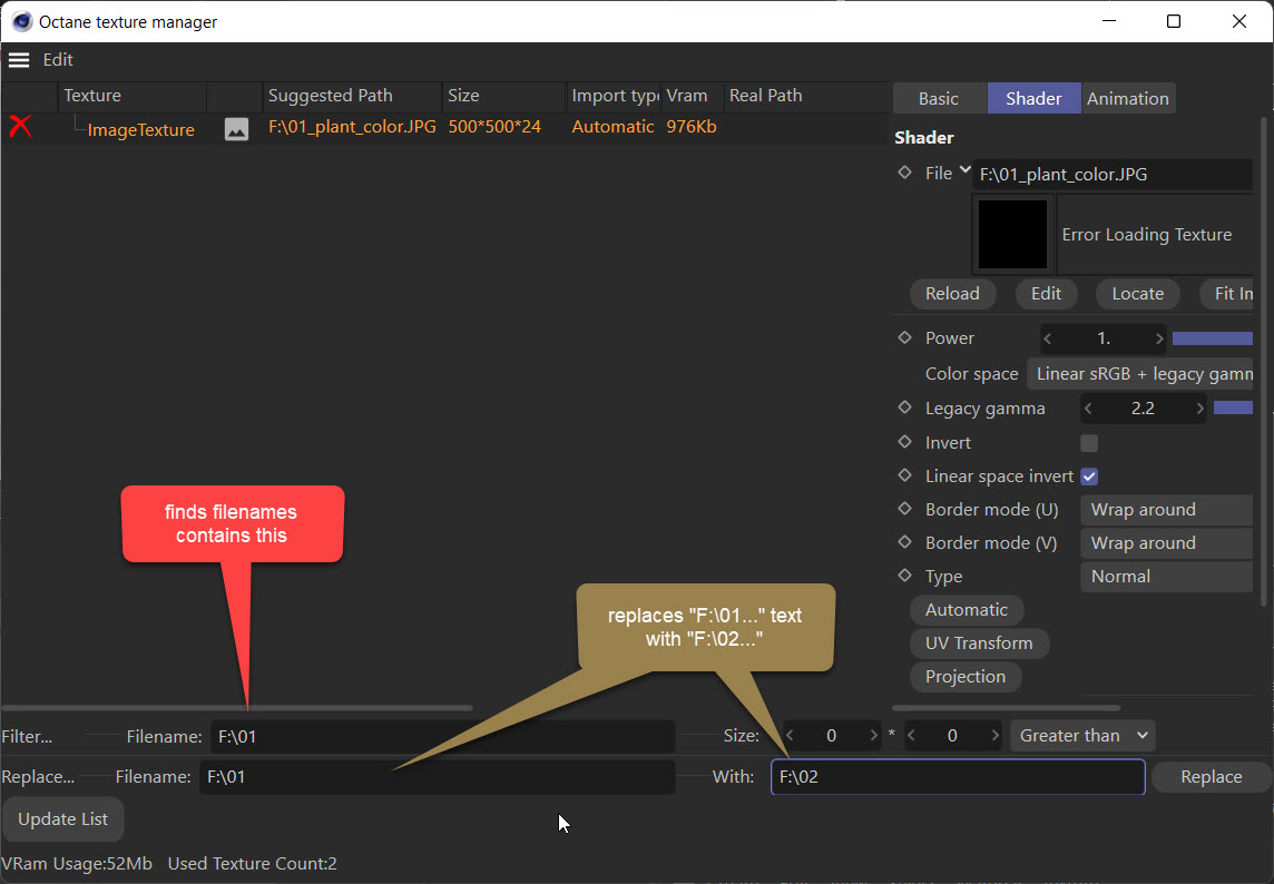

If we're taking texture manager requests, there's 1 thing which would bring a tear to my eye. The ability to find and fix texture paths in the project.
ie. a button or menu command called "find missing textures". You click it, and c4d asks you to select a folder/drive. Octane would then search the child folders for any missing texture files. Finally asking the user if they want to link directly to the file, or if they want to copy them to the local tex folder.
This would save me so much time when copying and pasting objects from one file to another.

boxfx wrote:If we're taking texture manager requests, there's 1 thing which would bring a tear to my eye. The ability to find and fix texture paths in the project.
You can do the same using standard C4D Project Asset Inspector.

Are you talking about this features? Assuming we have what you want. Isn't?

aoktar wrote:Are you talking about this features? Assuming we have what you want. Isn't?
Yes you can do the same even with simplified way because Asset Inspector finds missing textures automatically.

Missing textures are marked as red in our manager also. I don't get why do expect more
