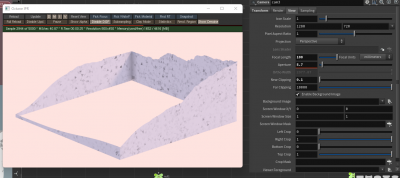

Octane glitches when rendering at very low camera aperture settings, see attached screenshot.
Changing the near/far clipping does not make any difference.

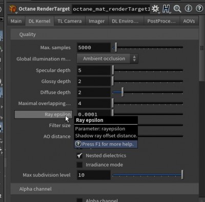

Can you please check if the ray epsilon parameter available in the render target kernel nodes tab helps?

Tuning the ray epsilon did work, but I'm animating the aperture so this requires animating the ray epsilon as well as creating multiple copies of the render target since I'm sharing that between my ROPs.. not great tbh.
