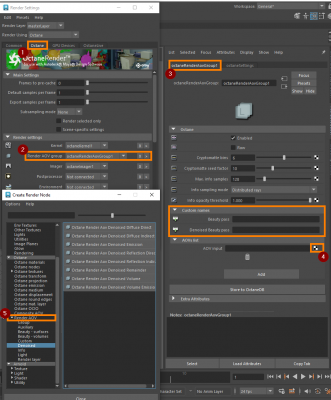

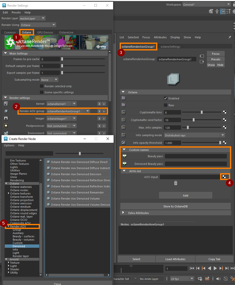

The old Passes node is changed as the Render AOV group node. When batch or current frame render we would get Beauty Main and DeMain beauty AOV if denoiser is enabled.
AOVs can be added using the checkbox as shown in the image below:

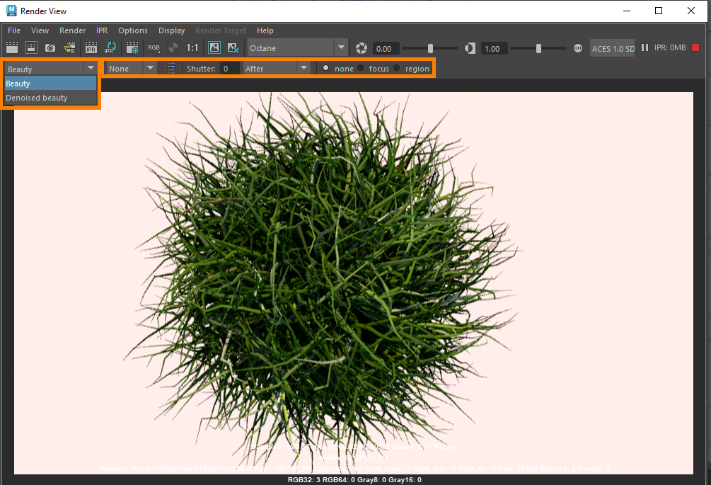

All the AOVs can be previewed from IPR window as a drop-down.
Octane subsampling, Render selected, Motion blur setting, Focus, and region render can be accessed from the IPR instead of having the Render settings dialog opened.
