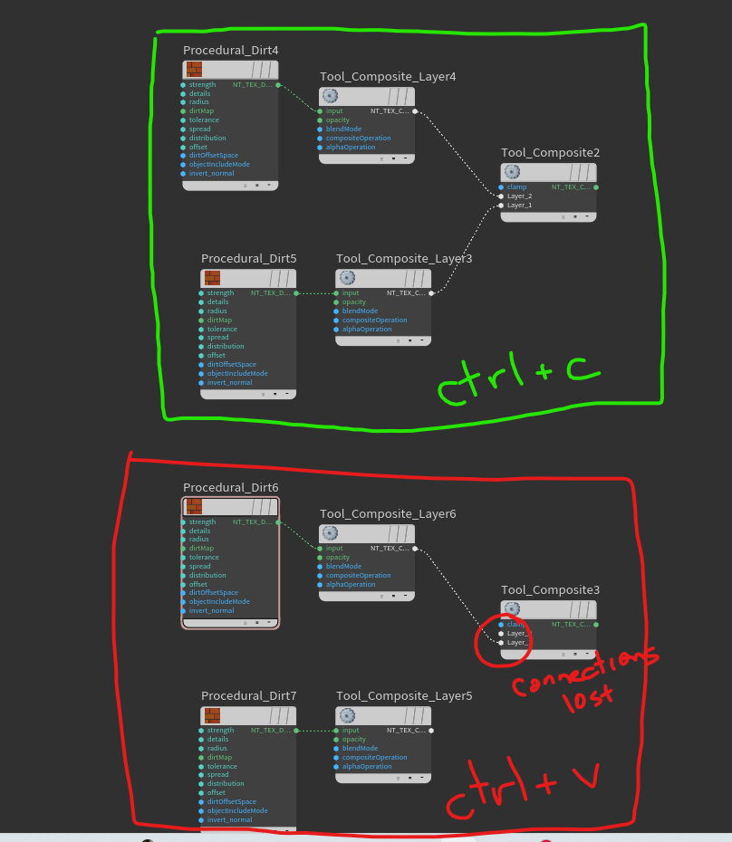

When I copy paste the nodes (see attached screencapture), the input connections to the tool_composite node get scrambled or disconnected.

The issue is that the composite tool has dynamic pins and changing from default 4 to 2 has lost the connection.
Would you please keep the default pins to 4 and see if it works?

keeping 4 pins wont work.. because the previous pins will be overwritten.. so if you put things in layer 1,2 you dont see them. I sent this issue to Juanjo today as well.

Thank you, heimlich! Just wanted to confirm if you are running the latest builds `Octane Solaris plugin 2021.1.5 - 08 08 22 [Test]` for H19.5.303.
We have set the default `Tool Composite` layer default to 4 but as you have said once we change the layer the node is created before updating the number of inputs, and the connections are lost. Copy/paste should work if we use the default 4 layers. Hope we could fix this in the later releases.
