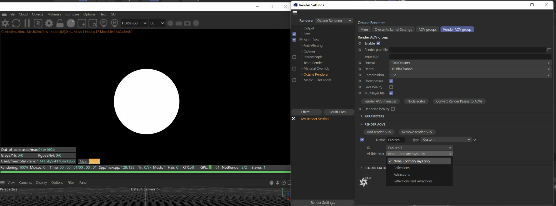

I have figured out AOVs, but I'm having a problem where I've set a custom AOV to this character, but the background sky/volume and some reflections are showing up in the output. I have set it to primary Rays only.
I set the character to custom AOV 2 in the object tag, and that's it. I also have a HDRI and 2 volumes in the scene.
Any ideas?

I think there is a glitch with Visible after popup selection :roll:
Try to choose a different one, then back to None - primary rays only mode:

I still get the same issue after trying that :(

AOVs are intended to provide a particular output, and often include indirect lighting and reflection contributions, depending upon the AOV chosen. If you want solid, output with no capture of indirect and/or reflected light, better to use a cryptomatte or object ID matte/AOV for that purpose.
If you post your scene, we can take a look.
