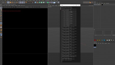

Toon shader crashes and material looks all black in the preview.

Posts: 10618
Please remove the installed c4doctane 2020.2-R3 version and upgrade to 2021.1.4-R4 new stable version.
You can find it by visiting your personal Downloads area:
https://render.otoy.com/account/download_archive.php
You need to select your purchased version from the Select Software pop up:
![](https://otoy.zendesk.com/attachments/to ... BFA00.jpeg)
Please use 7zip to uncompress the .RAR archive, it is free:
https://www.7-zip.org/
Then, please, go to c4d menu Script or Extensions/Console, (Shift+F10), and copy paste the default console output in your answer, thanks.
