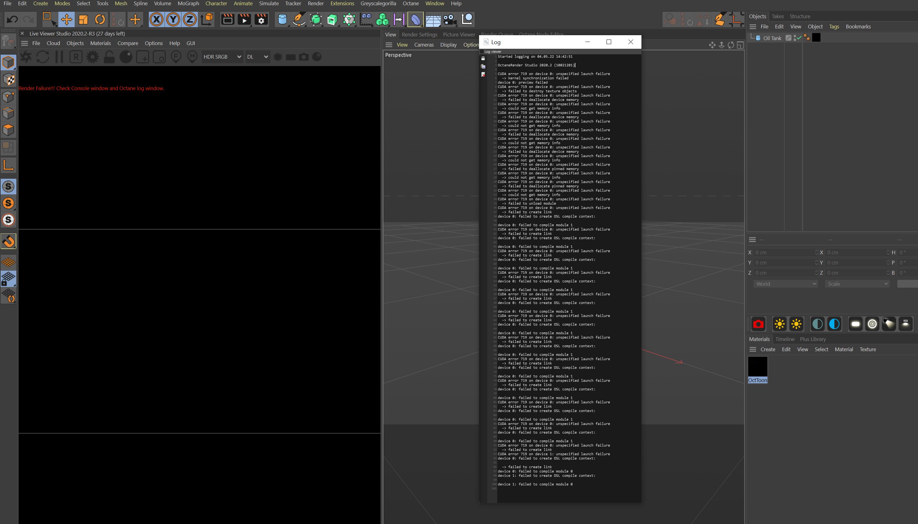

Toon shader crashes and material looks all black in the preview.
A. Operating System
Windows 10
B. Graphics Card(s)
RTX 2070 Super
C. RAM Capacity
32gb
D. Nvidia driver version
Studio Driver 511.79
E. OctaneRender Standalone version
OctaneRender Studio 2021.1.4
F. OctaneRender plugin version
OctaneRender Studio 2020.2 (10021201)
G. Host application version, including build number if available
Cinema4d R23.110
All back Toon Shader error
