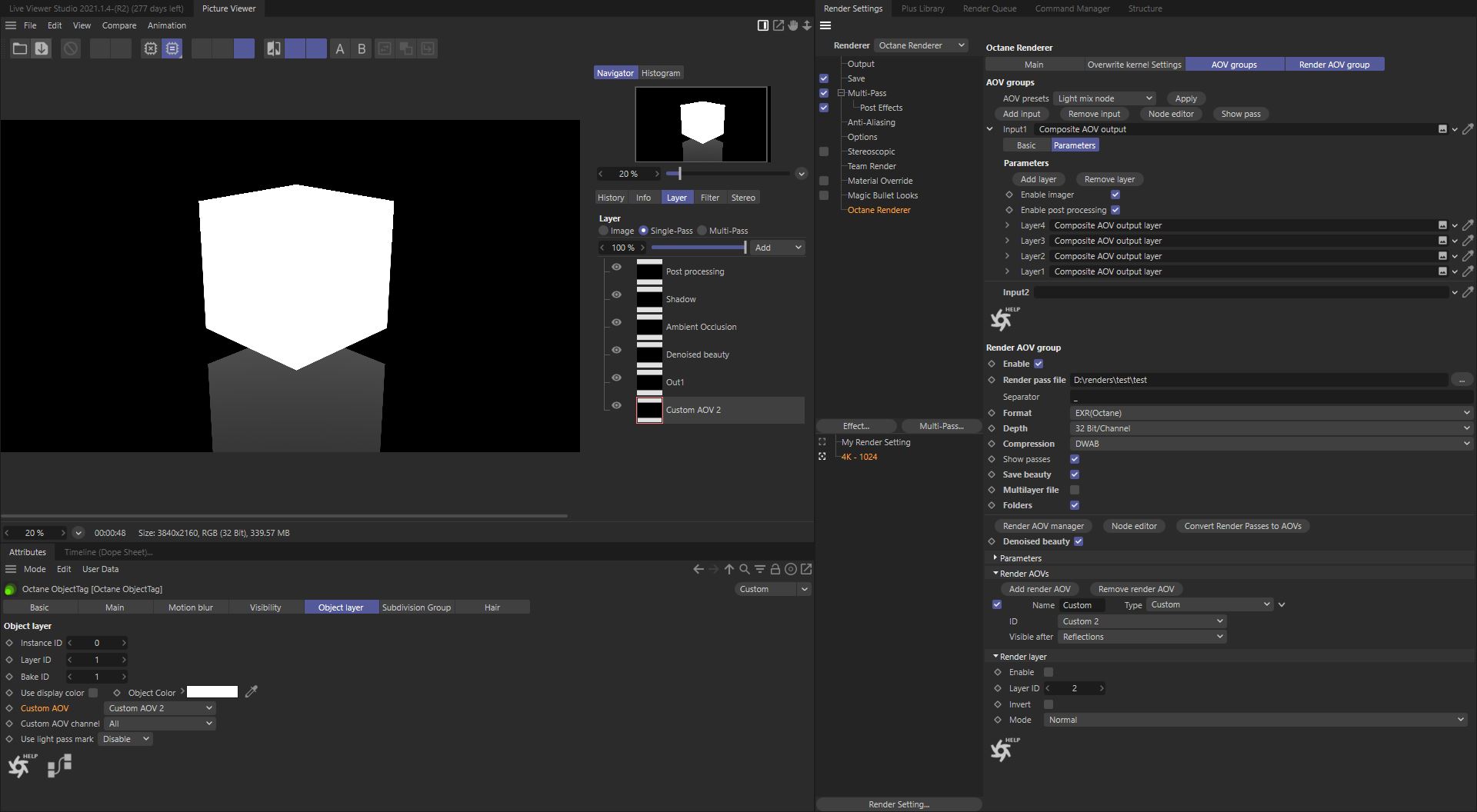

I'm having trouble properly rendering a custom AOV pass. I've added an octane tag to a cube and set it as Custom AOV 2 and set it to capture its reflections.

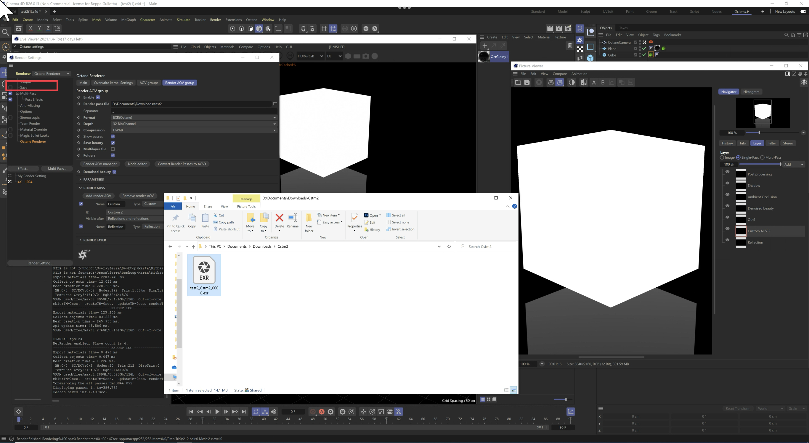

The Live Viewer shows the reflection in the Cstm2 channel and when I render the Picture Viewer shows the reflection in the Custom AOV 2 single pass. However, when I import the rendered file it is pure black.
Am I missing a key step in connecting the AOV to the rendered output? I have attached a screenshot of tag, picture viewer and the render settings. Below is the scene file. Thanks!

everything is working as expected here:
But please make sure to have installed the latest 2021.1.4-R4 version, or 2021.1.4-R3:
viewtopic.php?f=85&t=79494
And please avoid to use the C4D Save option in Render settings, and use only the c4doctane saving option, when you work in multi pass.
