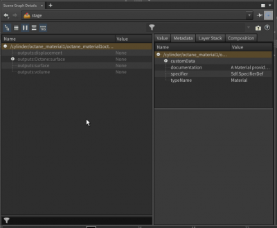

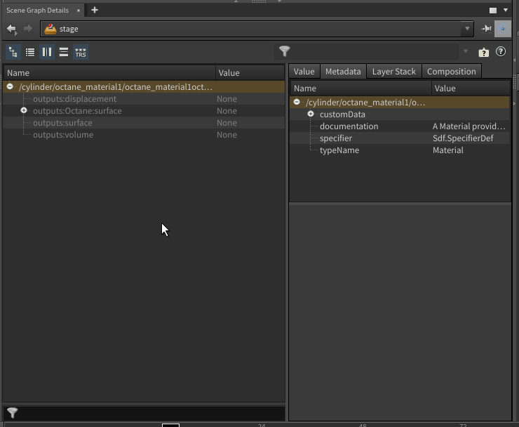

I'm experiencing an issue whereas when in the Scene Graph Details and I want to look at the vopnet output for the Octane material but it's not being shown ?

Thank you for the file..
Oh sorry, I mean outside the vop node.
Would you please help explain what we are supposed to see?
Here is a screenshot if we use the Octane Material outside of vop node:
cheers
Kind Regards
bk3d

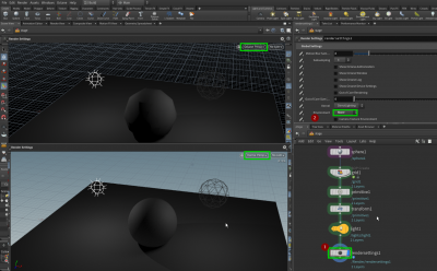

Hi Creative_Sheep,
Thanks for the update. The USD spherelight is emitting light but quite low power.
Please attach a Rendersettings node in the tree then disable the environment to None to disable the default Octane Daylight!
We have reported this to our developer to investigate maybe need an option to turn off the shadow of the sphere light.
As a workaround is creating own sphere light or use the Solaris default light and disabling the Shadow of the emitter Mesh.
Make sure to connect Render geometry settings node for custom mesh light.
cheers

Again, if there is no light in the LOP node trees, OctaneSolaris will create/add Octane daylight automatically by default (the daylight is very bright that killing the low light emission from Solaris light and USD sphere light). So, we need to add a RenderSettings node at the bottom of the node tress and disable the environment light.
Here is the renders after disabling Octane Environment:
cheers
