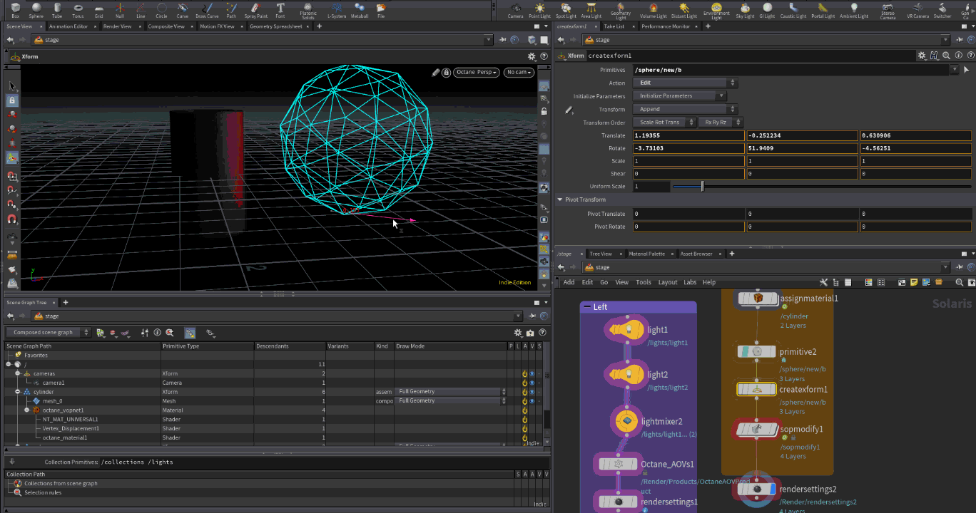

What you should see is the primitive by the name of primitive2 node which is creating a primitive type: sphere light lighten the cylinder but that is not the case. The created primitive is instead casting a shadow on the cylinder ?
Also the cylinder is not having the displacement applied ?

In Karma for example, the primitive2 lights the cylinder. I've communicated with the SideFX team and they have informed me it's an issue with Octane in which the SphereLight as the primitive type is not lighting the cylinder.BK wrote:Hi Creative_Sheep,Creative_Sheep wrote:What you should see is the primitive by the name of primitive2 node which is creating a primitive type: sphere light lighten the cylinder but that is not the case. The created primitive is instead casting a shadow on the cylinder ?

Although even if one disables the shadow caused by the Octane daylight, although I'm not using the Octane Daylight; the primitive2 is still not lighting the cylinder.

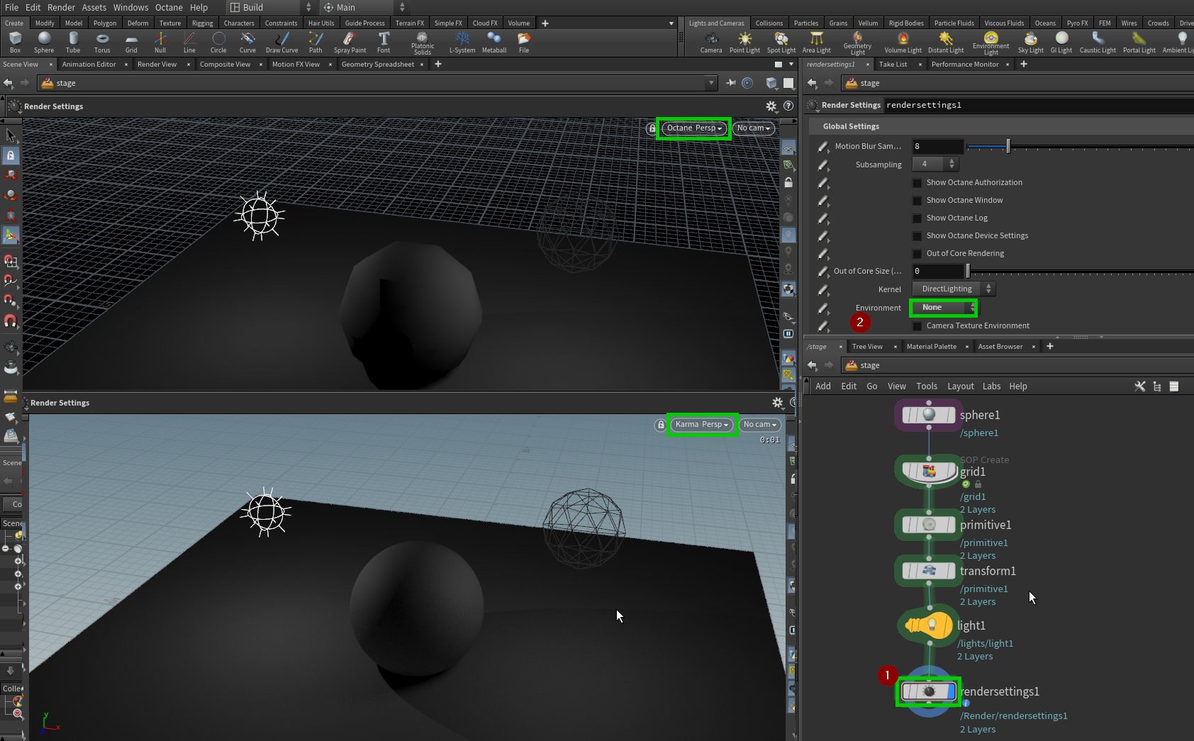

Thanks for the update. The USD spherelight is emitting light but quite low power.
Please attach a Rendersettings node in the tree then disable the environment to None to disable the default Octane Daylight!
We have reported this to our developer to investigate maybe need an option to turn off the shadow of the sphere light.
As a workaround is creating own sphere light or use the Solaris default light and disabling the Shadow of the emitter Mesh.
Make sure to connect Render geometry settings node for custom mesh light.
cheers

I was able to test in Karma and the scene which I posted in this thread, not only were the Primitive LOP with the Type set to SphereLight working but including any additional Solaris lights added to the scene as well plus displacement maps.
That isn't the situation with Octane. When adding a Primitive LOP with the type set to SphereLight, then adding a Solaris light, the Primitive LOP: SphereLights automatically become disabled instead of illuminating the scene as well as the Solaris lights. I believe this may be a bug considering it works in Karma.

Again, if there is no light in the LOP node trees, OctaneSolaris will create/add Octane daylight automatically by default (the daylight is very bright that killing the low light emission from Solaris light and USD sphere light). So, we need to add a RenderSettings node at the bottom of the node tress and disable the environment light.
Here is the renders after disabling Octane Environment:
cheers
