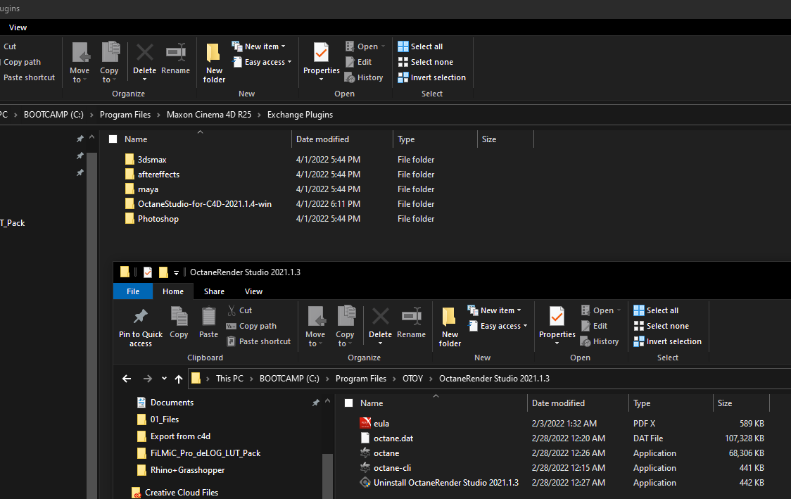

Yes, of course.
Now I've tried to move the plugin folder to the exchange plugins folder of C4d. Now it starts but I can't see octane null part.

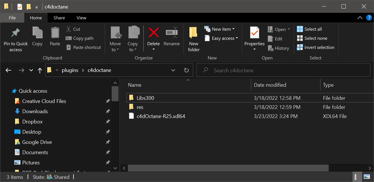

You do not have the plugin installed correctly. You need to create a directory called "plugins", without the quote and a lower case "p" in the Maxon directory. You should then place your c4doctane directory in the plugins directory. Your c4doctane directory should look like this:

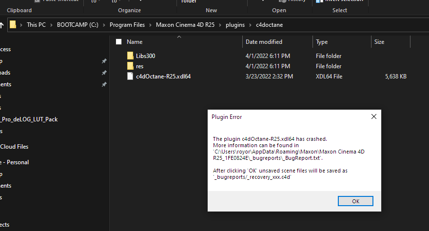

I did it but it crash.
