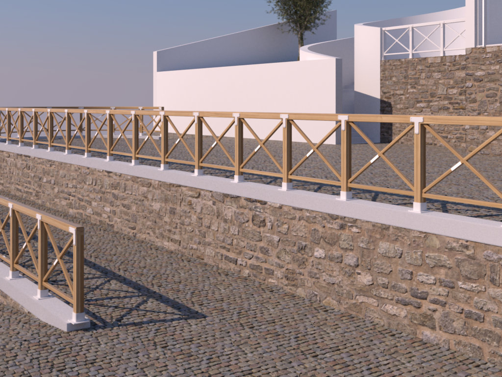

Hi all,
it's possible to avoid the repetition of the pillars map without remapping every single pillar?
thanks,
Roy

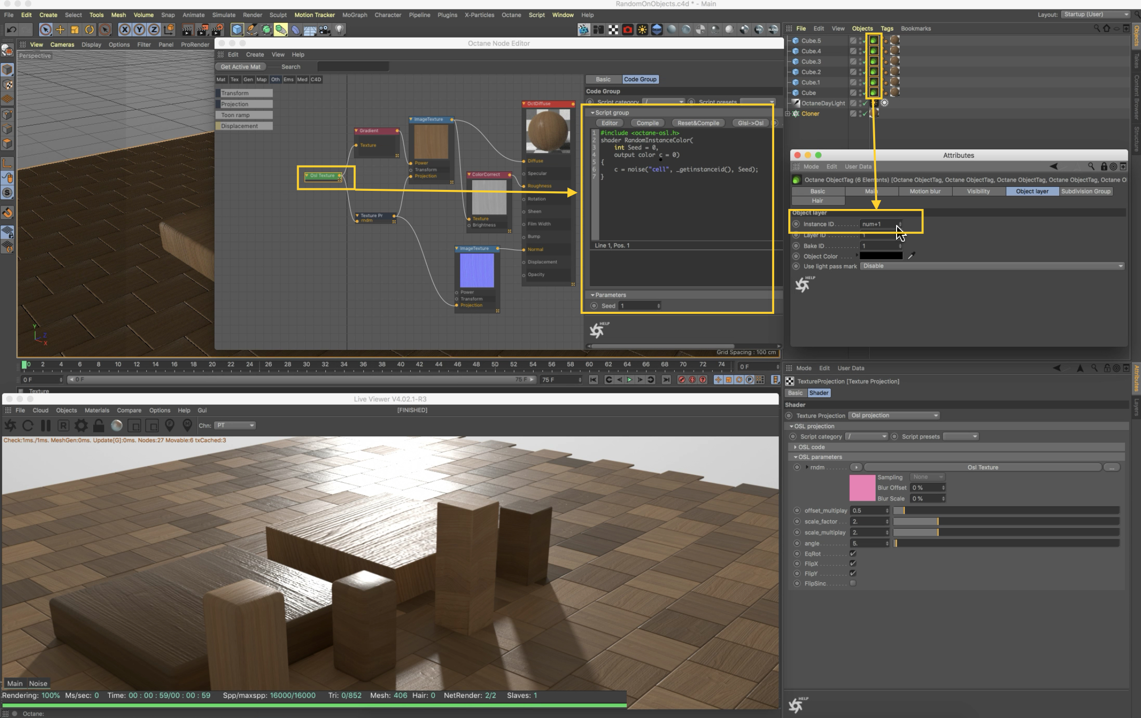

Posts: 10575
Ciao Roy,
yes there is, if you look at the latest example in the second link, basically you need to assign different Instance ID numbers to your objects:
download/file.php?id=73220
ciao,
Beppe

Posts: 10575
Oops, never tried octane with Rhino :oops:
Basically you need to reach the Object Layer node connected to Geometry node, try to have a look at Geometry Live Update:
https://docs.otoy.com/RhinoH/RhinoPlugi ... tryTab.htm
