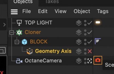

Hi, I am using PR14 R25 on a mac and getting weird results when animating a primitive inside of a cloner

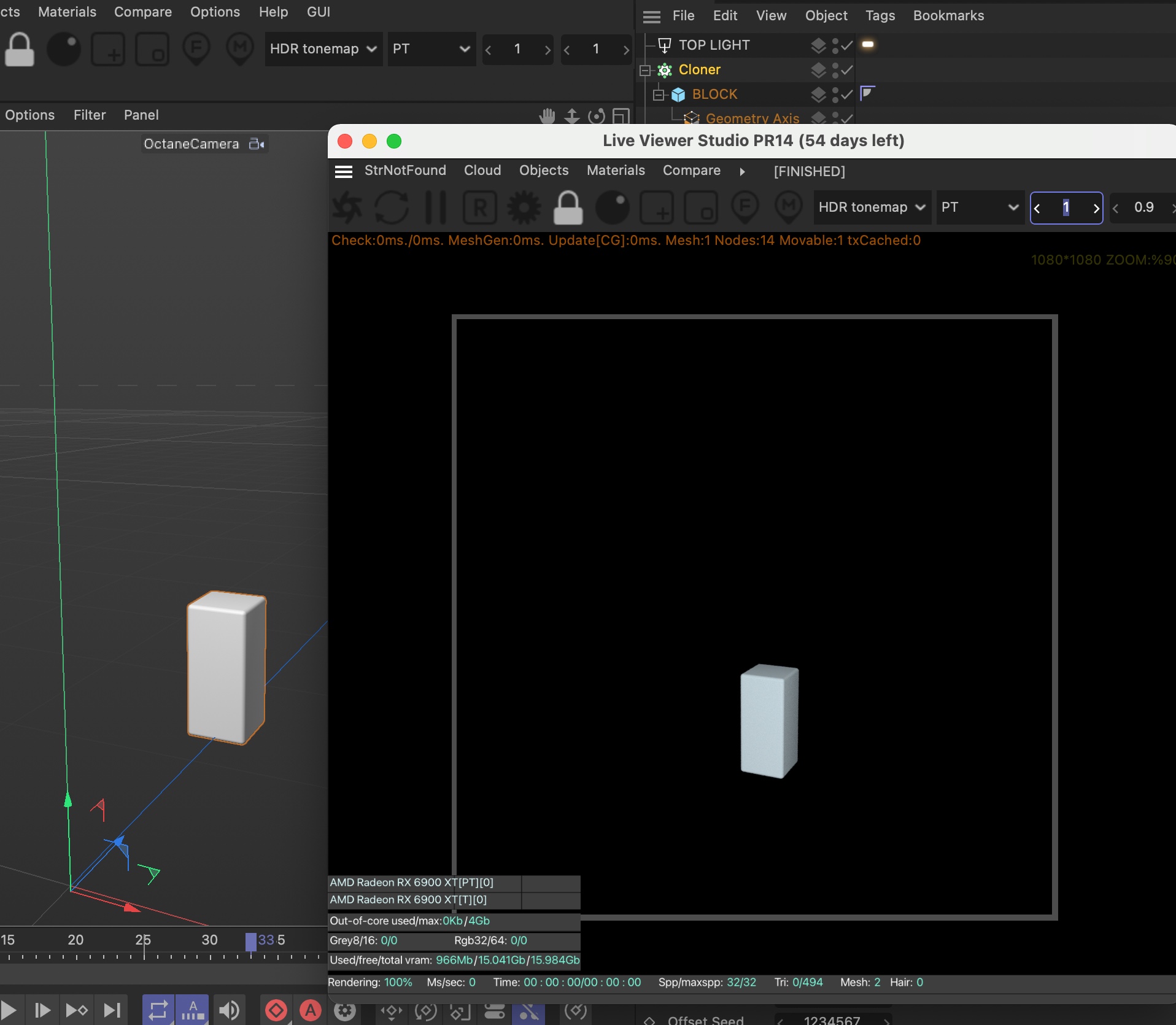

When viewing in Octane's live viewer you can see cube animate,
Live viewer
Live viewer

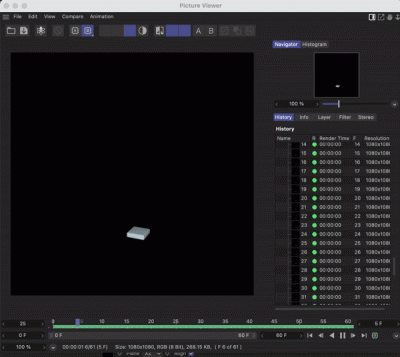

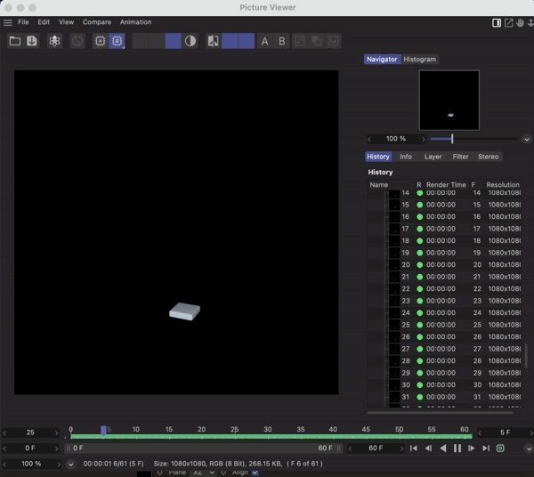

but when rendering it's stuck on the first frame:
Stuck on first frame

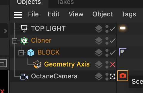

I can fix this by disabling Geometry Axis Scene Node Deformer, or by moving the cube out of the cloner. So I assume it's Geometry Axis that's the culprit?:
Any clues why this might be happening?

new c4d scene node system is not supported in c4doctane.
You need to take out the Block from MoGraph cloner, use the Bake as Alembic command, and use it inside the cloner:
