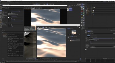

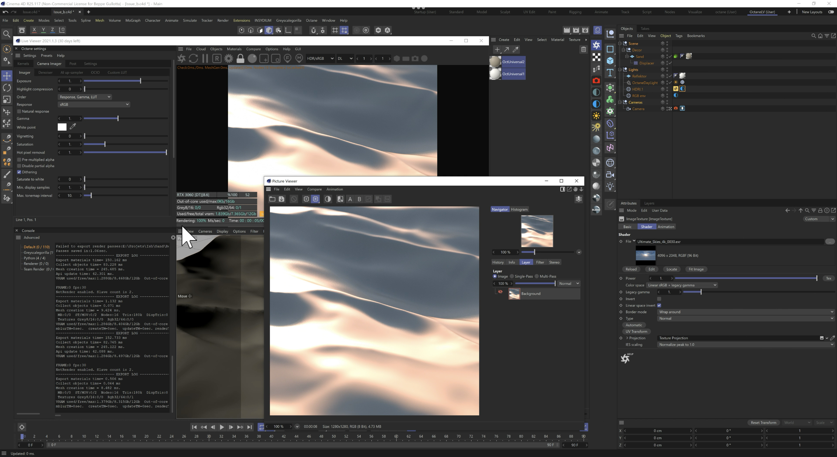

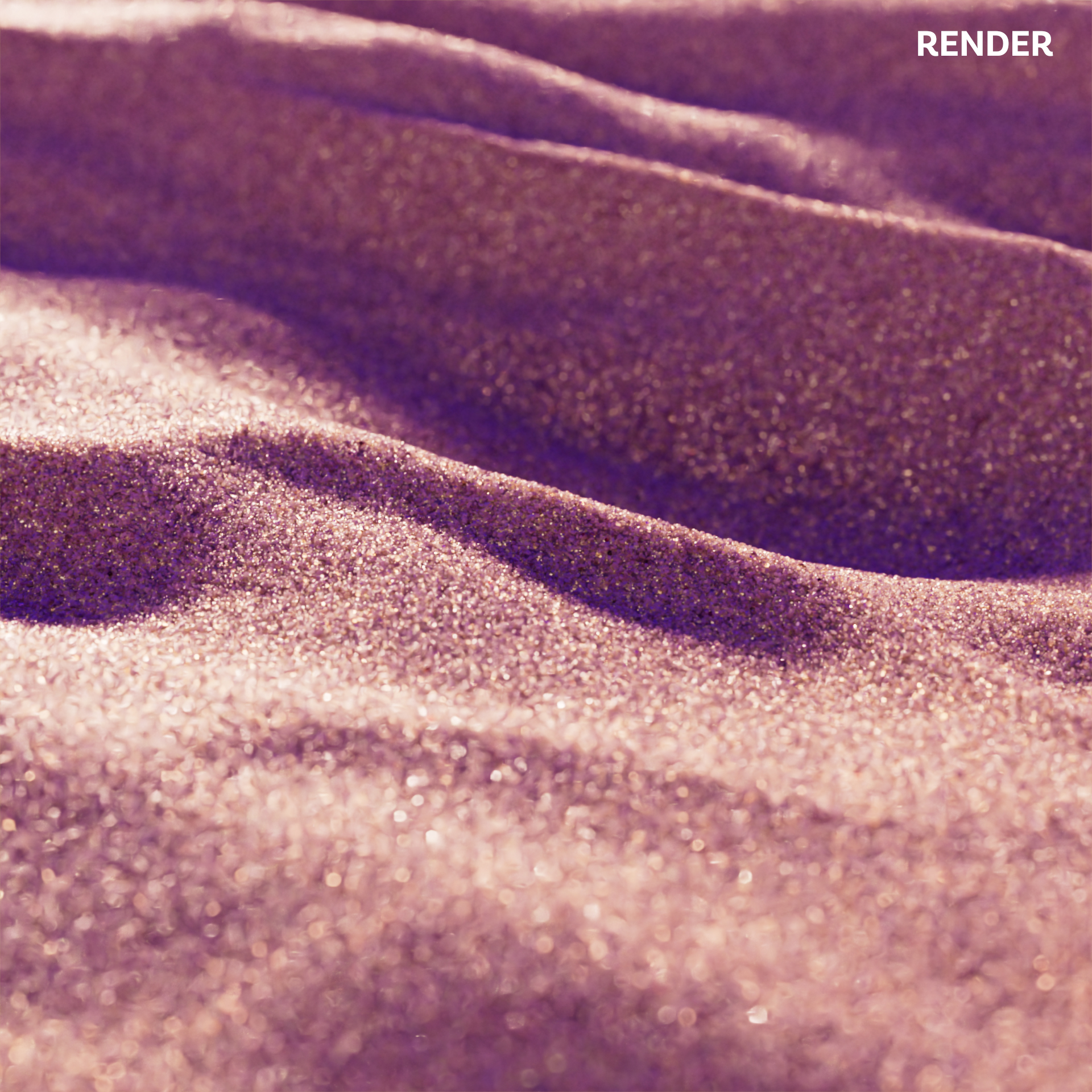

Yesterday, my LV was different than my render.
The issue seemed to be with the mixing of the daylight and the HDRI : in the LV the sun color was completely ignored, but in the render it was coloring the whole scene in purple.

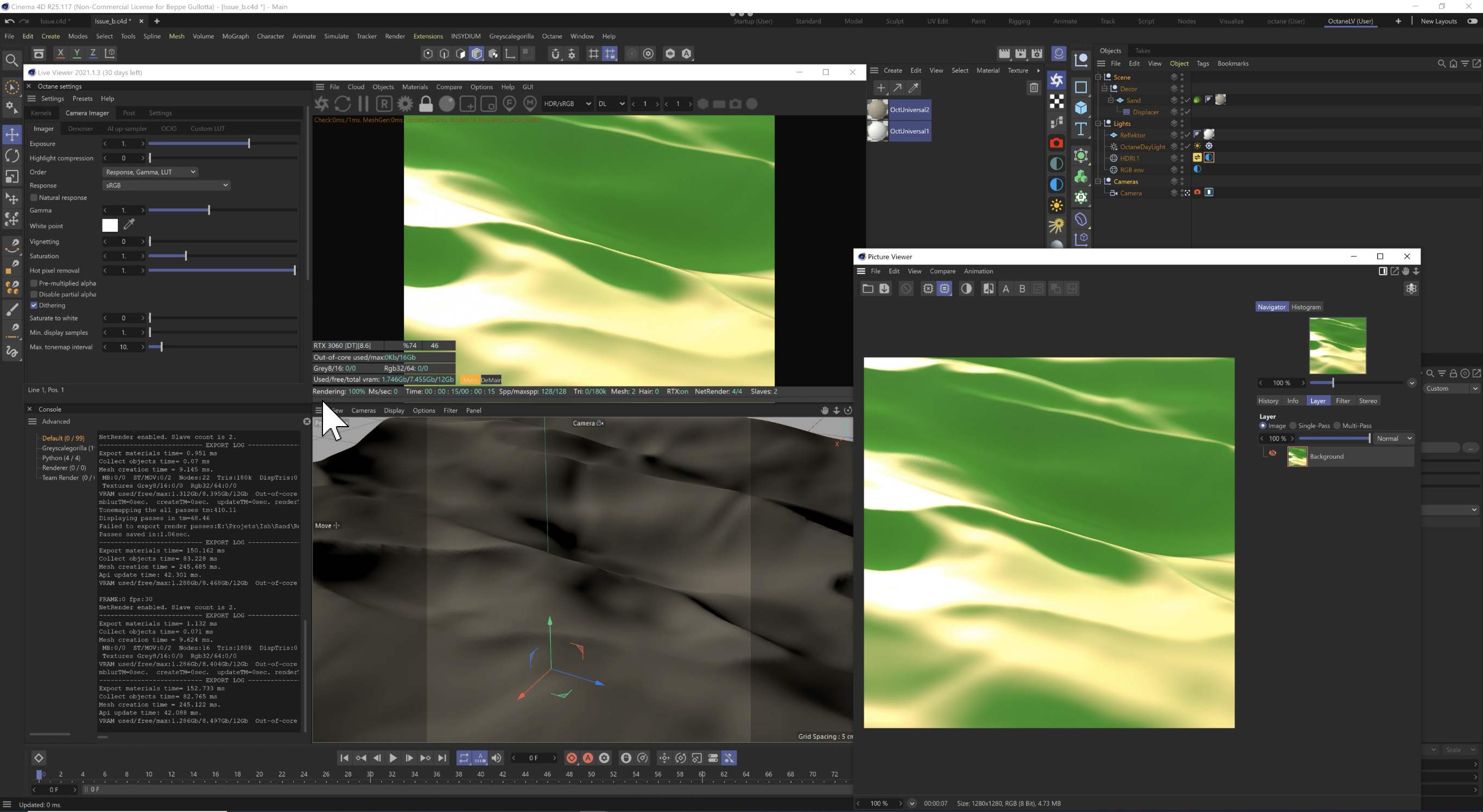

I attached a simplified version of the scene, with a green sun so that you can clearly see what's wrong with the (green) render compared to what you see in the LV - no matter what your colorspace is.

Your expected result is wrong. Sky texture/color will replace daylight's sky color. So LV result is correct. You can check it in Standalone if you wish to be sure. Btw I don't know why it's greenish in Picture Viewer but it's wrong result.

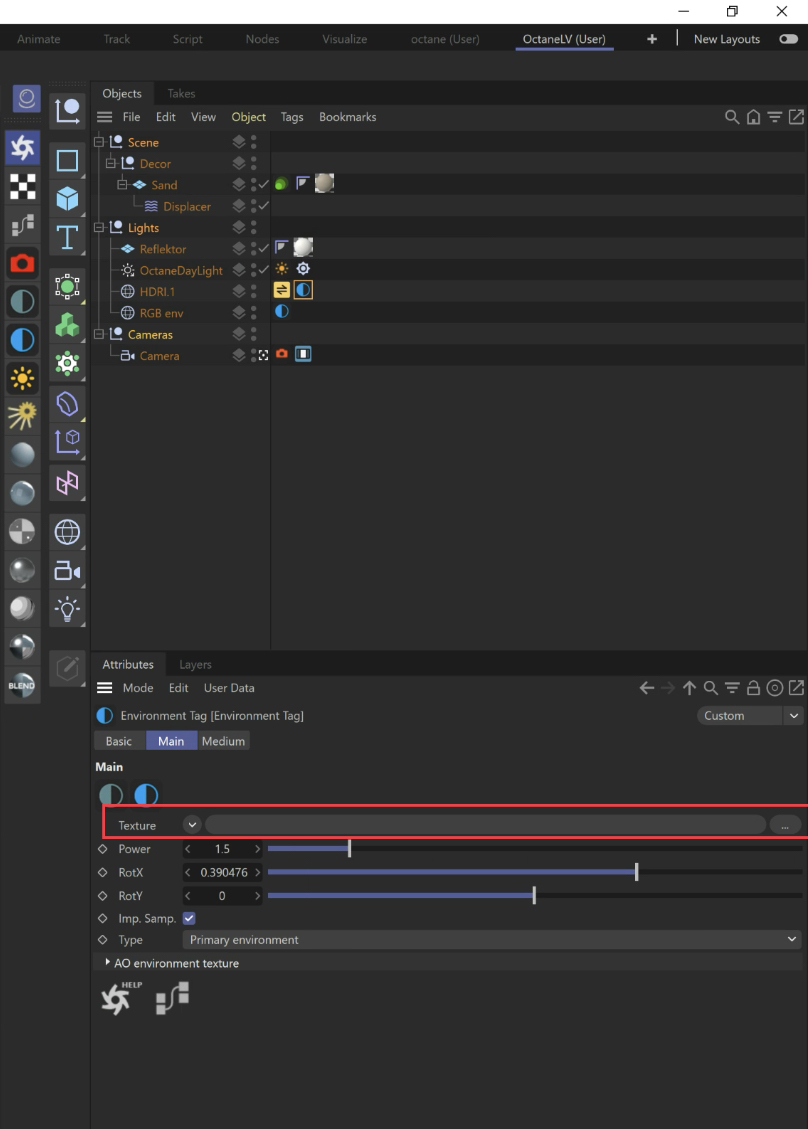

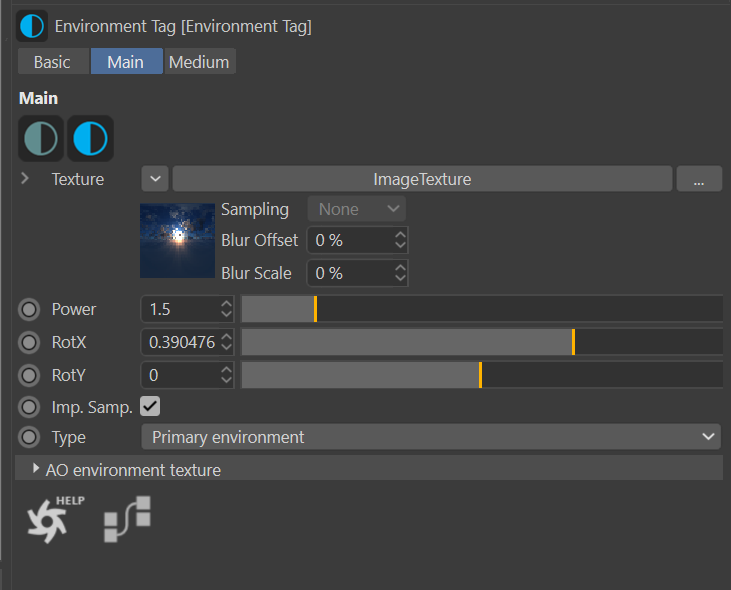

the issue seems related to GSG HDR Link Plus node, if I copy paste everything from your scene into a new scene, the Texture node is missing: And the result is greenish in both Live View and Picture Viewer: If I reassign the correct HDR texture you have shared, Live View and Picture Viewer give the same result: ciao,
Beppe
