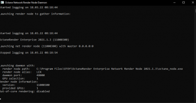

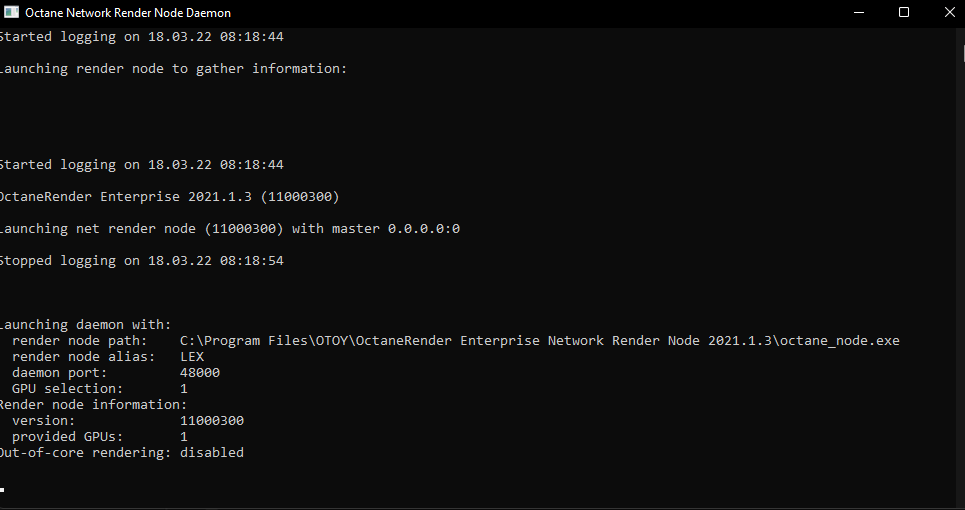

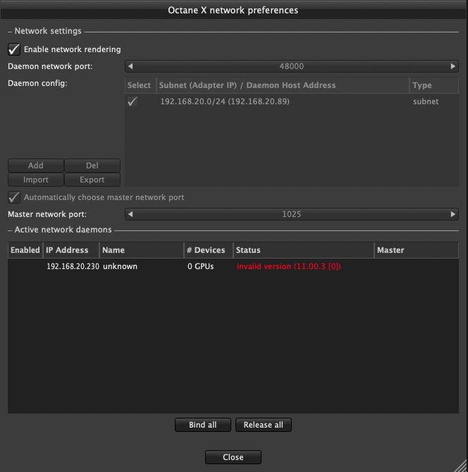

Is it possible to use a m1 pro macbook pro as a main render machine (Using Octane X PR13, R25.117) with a PC - using 2021.1.3 as a render slave (3080ti)
Which versions of Octane speak to one another between Mac and PC?
My network rendering is currently active on port 48000 on the mac and the pc is visible in network preferences its just sayting - invalid version (11.00.3 [0])
Is there anything i can do? Any help would be greatly appreciated.

No sorry, it is not possible to mix Metal and CUDA render-nodes for network rendering yet, but we are almost there.
OctaneX is still based on 2020.1.5 SDK, with some addictions, while PC version is at 2021.1.3 SDK.
We need to wait for the next upcoming 2022.1 SDK, to have an OctaneX version based on the same SDK as CUDA, and to be able to experiment Net render in a mixed environment, with both CUDA and Metal Render-Nodes.
Stay tuned...
