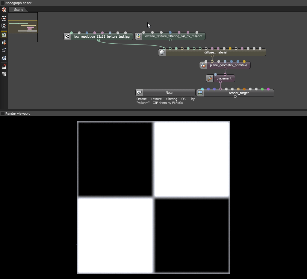

Hi, I'm researching using Octane to create pixel art, and so attempting to minimize/turn of AA. I've set filter size to min (.001) and tried each kernel, but I'm still seeing too much AA. Possible? Any tips?

Thank you elsksa!

Just bumping this again. Although this OSL node helps with texture aliasing, I'm still having issues with the alpha channel. With minimum filter size the alpha is still aliased. Any tips on how to remove aliasing there?
Posts: 10564
have you tried with "Disable partial alpha" checked, in the CameraImager node?

Perfect! Thank you Beppe!
