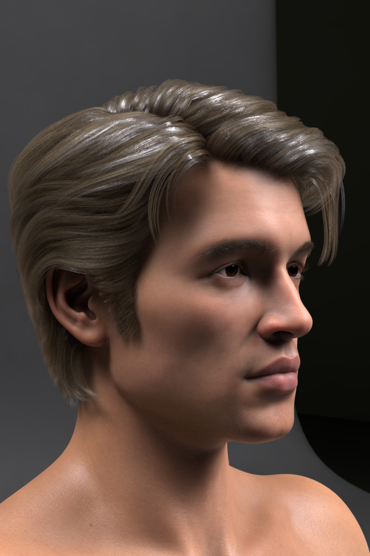

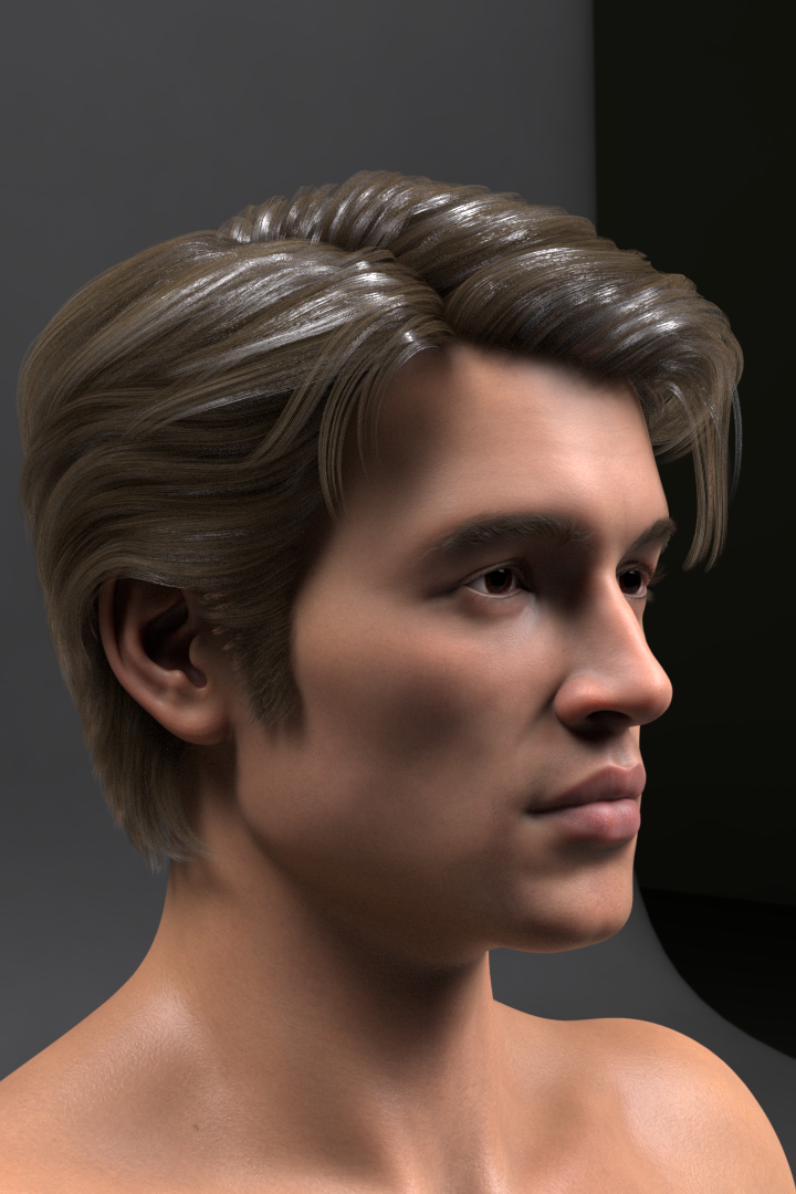

So I was working on making a hair shader and decided to experiment with the specular material. However I noticed that it creates some very bright highlights that remain even when I turn the reflectivity to 0. Is this intended? Is there a way around it? The hair is flat planes that use alpha maps by the way, not strand/fiber based.
Bright highlights with specular material setup
Bright highlights remain when reflections turned down to 0

I would avoid using Specular Material for Hair since the "very bright highlights" are most likely refractions. Can't really know for sure since i also don't use Hair Cards. Specular Materials are used for glass, liquids, etc.
Use Universal Material instead.

galleon27 wrote:I would avoid using Specular Material for Hair since the "very bright highlights" are most likely refractions. Can't really know for sure since i also don't use Hair Cards. Specular Materials are used for glass, liquids, etc.
I started doing this and using the thin wall (diffuse) option and the results are satisfactory. :D
