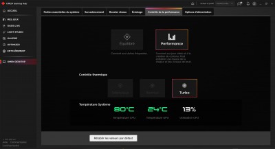

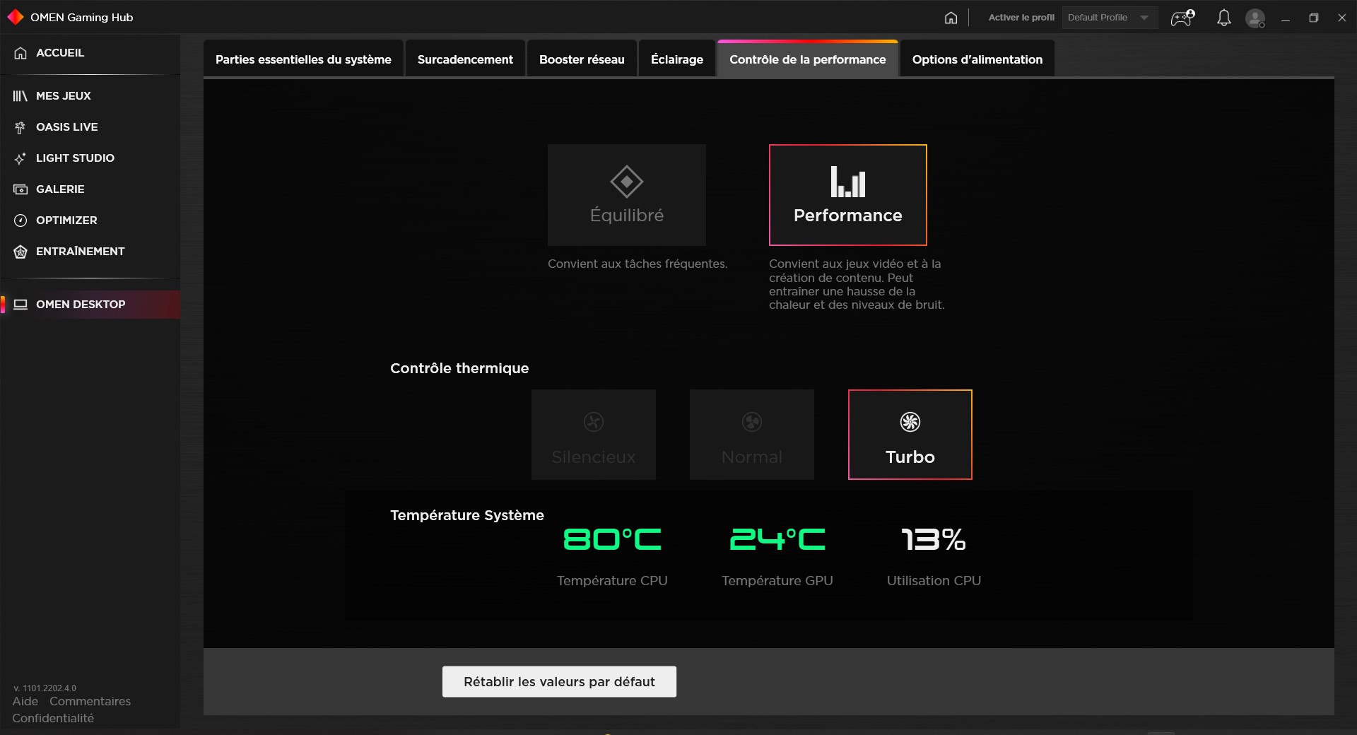

I think I have found the solution since then. This involves making adjustments on the "Omen Desktop" application by configuring the "Performance Control" tab on "Performance" and "Turbo" (see screenshot). Can you try this and say if it works for you please?
Thanks to you

I think I have found the solution since then. This involves making adjustments on the "Omen Desktop" application by configuring the "Performance Control" tab on "Performance" and "Turbo" (see screenshot on my previous message). Can you try this and say if it works for you please?
Thanks to you
