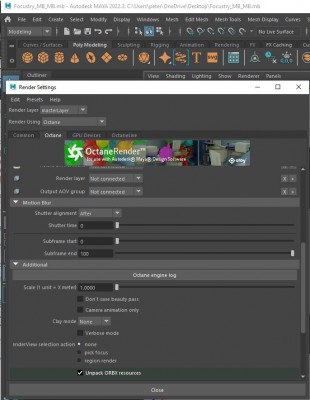

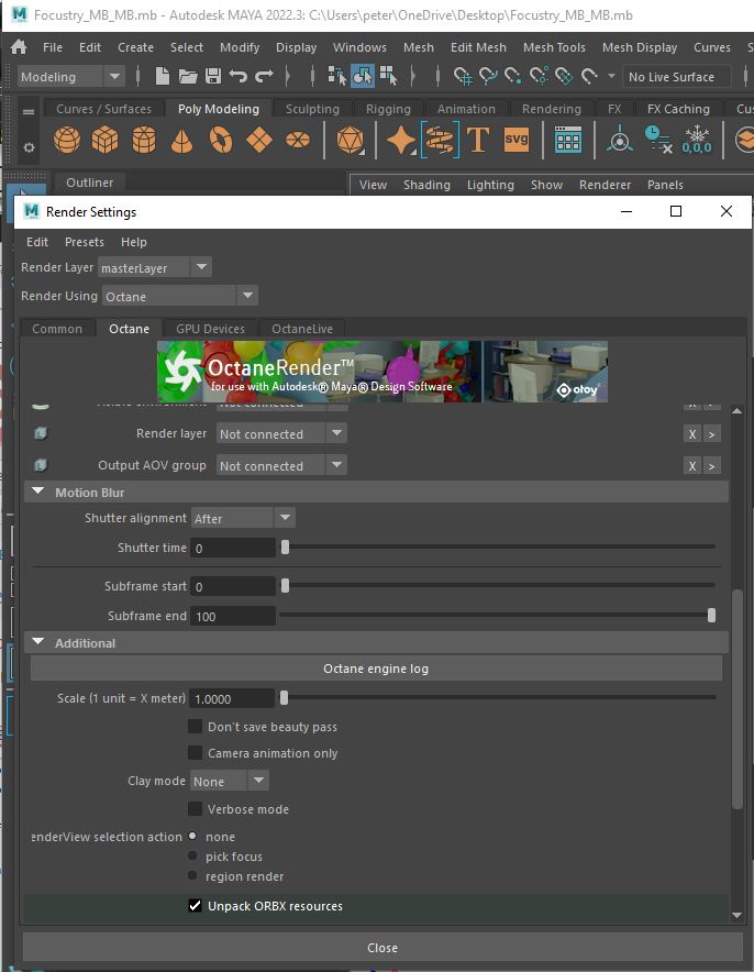

p3taotoy
Posts: 227
Joined: Sat Nov 24, 2018 1:06 am
Location: Washinghton, USA and Waikanae, New Zealand
Sorry where is this? My brain is full and I don't know what you are referring to
BK
Posts: 1588
p3taotoy wrote:Sorry where is this? My brain is full and I don't know what you are referring to
Hi Peter,
No worries, its under Rendersettings dialog>Octane>under Additional Rollout or can do from the IPR RenderView window!
Please let us know if that helps!
cheers
Kind Regards
bk3d
p3taotoy
Posts: 227
Both on the demo scene I sent and my scene it is set to none.
So I don't think it is that.
If when you opened the demo scene I sent it was set to pick focus then it defaulted to what some settings you may have. Mine was none.
BK
Posts: 1588
p3taotoy wrote:Both on the demo scene I sent and my scene it is set to none.
Hi Peter,
Thank you so much for the update!
Jim has suggested this issue is related to our engine's normal precision restriction(limitation).
Would you please try adjusting the scene scale as a workaround and see if it fixes?
cheers
Kind Regards
bk3d
