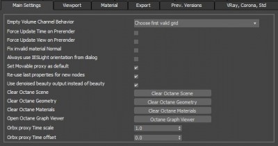

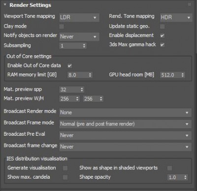

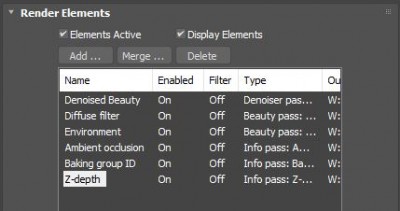

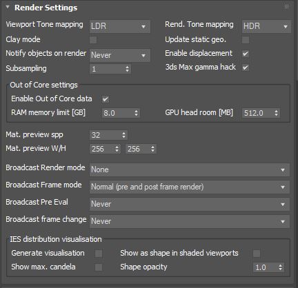

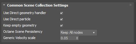

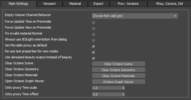

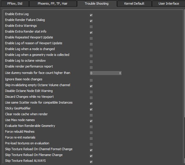

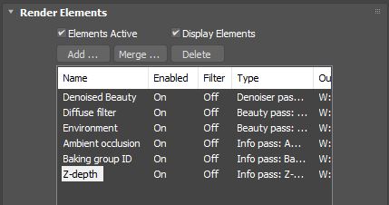

Hello there, I have this problem and I dont know what to do anymore
I have a scene with 10 millions polys. I have all the objects with "movable proxy" OFF, and just one bird wich is the only animate geometry with "movable proxy" ON.
When I open de Live view, the screen keeps in "scene evaluation" for almost 3 minutes, then the image shows up, and I can move the timeline and the image just updates in real time just fine.
All good at this part, all seems to be working perfectly and optimized. But the deal starts when I press RENDER. It just take 3 minutes each frame, and just 10 seconds the final render part.
It have the "refresh geometry each frame" behavior. Keeping all black for 3 minutes, and the last 10 seconds just render the engine part.
I'm pretty lost here, I need some good finger pointing somewhere
I have 3D Max 2019 with Octane 4.05 - 6.34
NVIDIA GeForce GTX 1070
32GB RAM
LV updates animation fast, render evaluates scene each frame
ISSUE UPDATE
I figures out a hint... As I said before, I have 10 million polys in 33 objects around the scene, conforming the scenario, all with "movable proxy" OFF
and only one mesh with "movable proxy" ON (a bird) with 400 polys.
What I figured out is if a hide the bird, the render only compute the scene in the first frame, and all the rest just render with no precalculations, all great. but what I need to solve, that I cannot understand is.....
HOW THE F*** DO I MOVE MY ONLY 400 POLYS MESH WITHOUT COMPUTING ALL THE F****NG 10 MILLIONS OF STATIC MESH????

Hi iniaki13,
honestly, managing all these polygons (also with high resolution textures and hdris) having 8GB VRAM and only 32GB Ram, to manage the operating system, other applications and screen/s seems difficult. Try setting the whole scene to movable proxy and not grouping large quantities of polygons together. Eventually increases out-of-core to 12GB.
