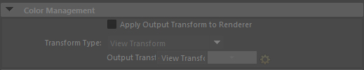

I'm having trouble with the "Apply Output Transform Option Box" being grayed out in the render settings. Any ideas on why this happens?

Hi David,
Thank you so much for the screenshot!
It seems the Color Management rollout belongs to native Maya.
Octane's OCIO color management can be found under RenderSettings>Octane>OCIO rollout!
here is the quick setup to use Ocatne's OCIO
viewtopic.php?p=403379#p403379
