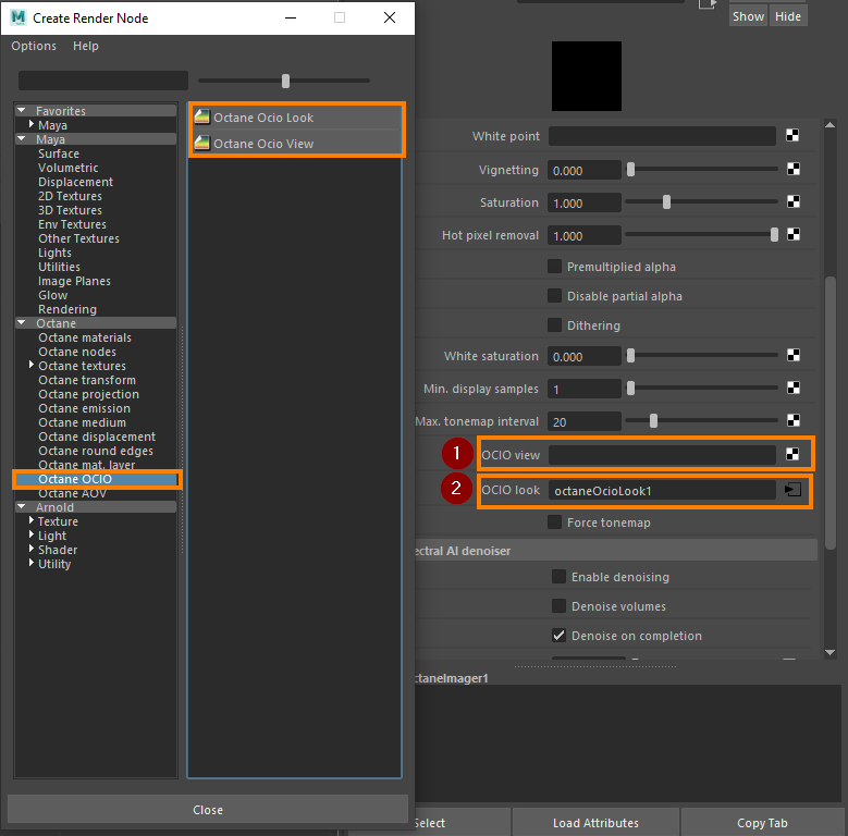

I have not been able to preview in ACES sRGB in octane with maya... And there are several places (with several nodes) where to look.

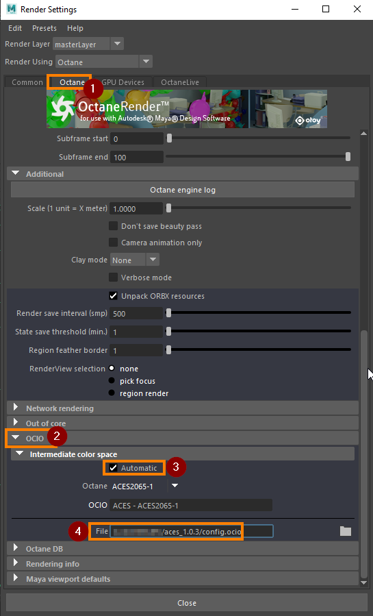

- In the render globals; where I have even loaded an ACES 1.1 file... config.ocio
- In the imager; There are Ocio look and Ocio view, but I have not managed to connect it well (I guess, because I do not see the desired result)...

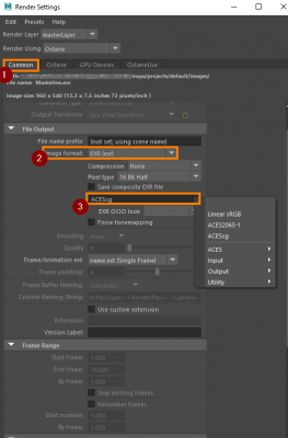

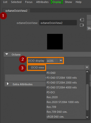

Also, please confirm if the workflow is the same,
- Load OCIO configs from the Octane>OCIO rollout
- hook up the OCIO View and the OCIO look node on the Imager node
- we can load the color profiles from the OCIO view node
- please follow the steps for the render outputs

Is this ACES workflow still valid in Otoy version 2023.1.1 22.10?
BK
Posts: 1595
pippojasper wrote:Is this ACES workflow still valid in Otoy version 2023.1.1 22.10?
Hi pippojasper,

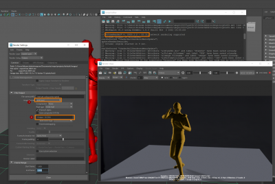

Thank you for the post.
Recent changes due to Maya Render view buffer limitation.
Once we set the Image format to EXR, then the Octane View would work from the *Select OCIO color space* field.
Please let us know if this works!
