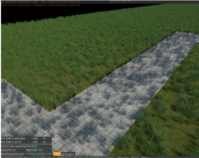

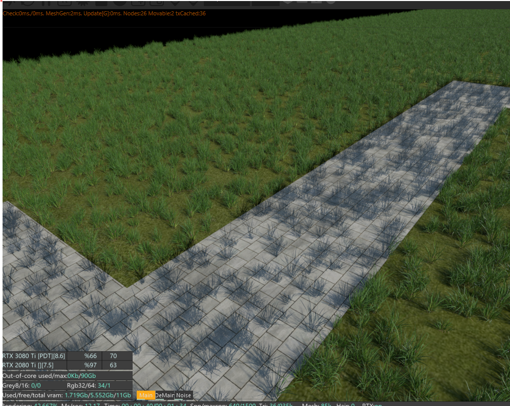

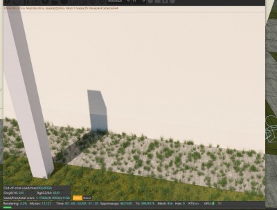

That kinda works, my floor is now excluded in clipping but my grass shows up now as kind of a ghost?
screenshot and scene attached

You are not using Octane Object tags in your scene. Add one to the Hof.1 object, and in the tag's Visibility tab, disable Shadow Visibility. This will remove the shadows from being cast from the clipped objects.

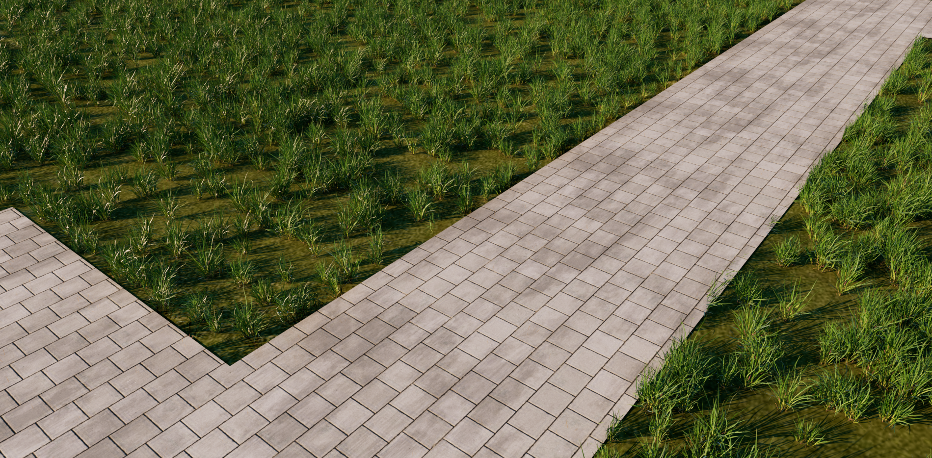

Thanks, thats pretty counter-intuitive but it works now, cool thing, thank you

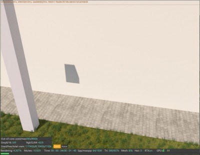

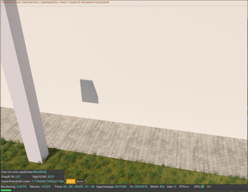

I've noticed a new problem which i dont know a way around - the clipping material prohibits shadows from falling on objects that are "inside" the clipping objects. (See screenshots and scene attched)
is there a way to fix this?

I don't think that Clipping Material is good choice to make such things. Anyway it should not block shadows that coming from not clipped material...
