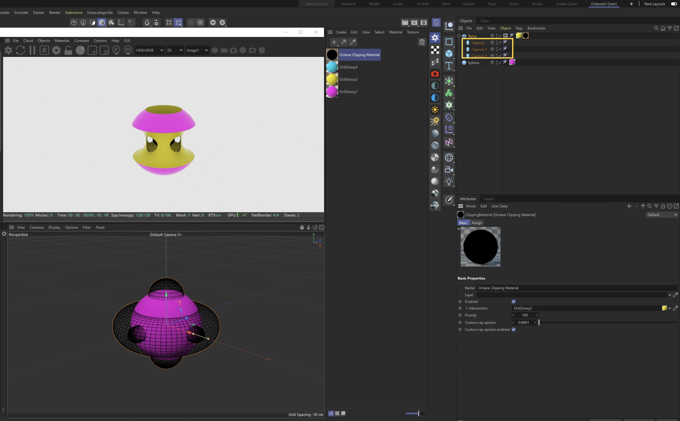

Materials with a priority higher than the clip material priority will be exempt from the clipping operation. Clipping uses the same priority as Nested Dielectrics. You can fine tune artifacts by using the Clip material Custom Ray Epsilon value.
To use your example, if you assign the sidewalk a higher priority than the Clipping material, it will be untouched by the operation.

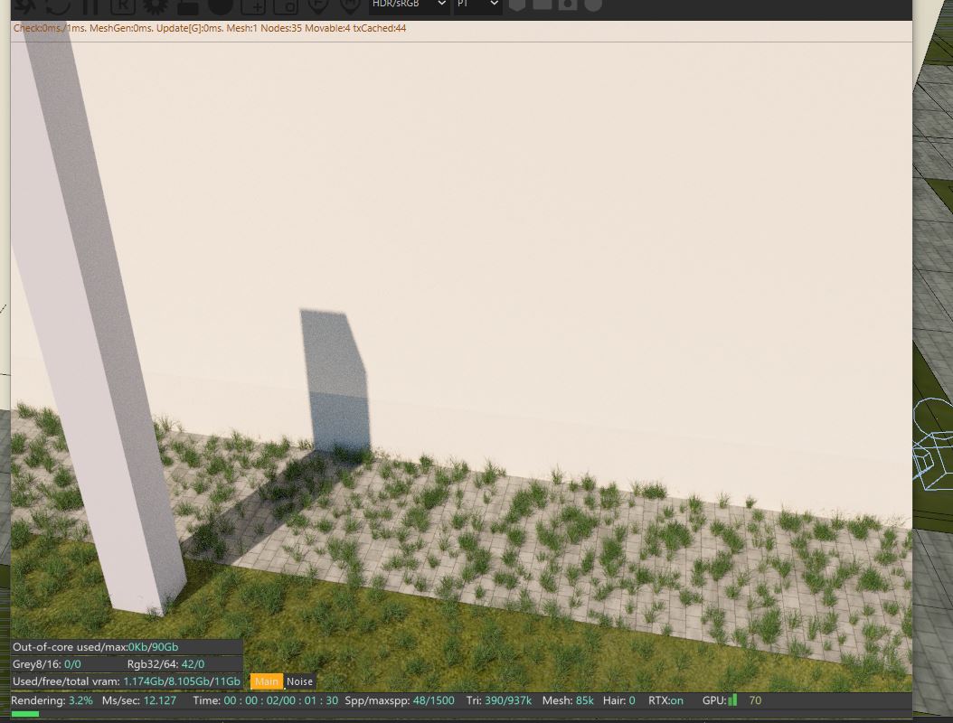

That kinda works, my floor is now excluded in clipping but my grass shows up now as kind of a ghost?
screenshot and scene attached

You are not using Octane Object tags in your scene. Add one to the Hof.1 object, and in the tag's Visibility tab, disable Shadow Visibility. This will remove the shadows from being cast from the clipped objects.
Puget Systems / Intel Core Z790 ATX / RTX 4090 / Cinema 4D
I've noticed a new problem which i dont know a way around - the clipping material prohibits shadows from falling on objects that are "inside" the clipping objects. (See screenshots and scene attched)
is there a way to fix this?

I don't think that Clipping Material is good choice to make such things. Anyway it should not block shadows that coming from not clipped material...
