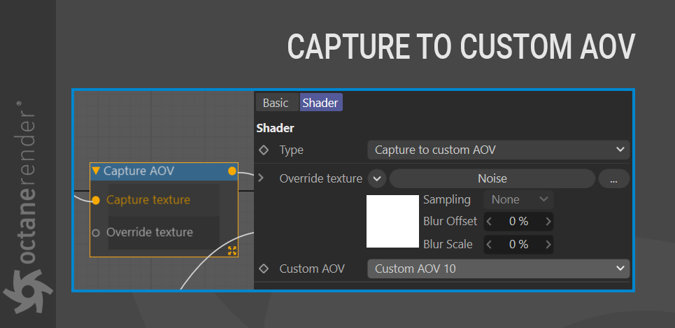

Textures and other material attributes can be used in an AOV composite via Capture to Custom AOV texture nodes (Node Editor > Tex > Custom Texture). The idea is to write the input texture to the specified Custom AOV and pass the input texture value through to the destination of the capture texture node. An "override" texture can also be specified which will be written to the Custom AOV instead. The input texture is still what is passed through to the destination. This is useful if you either want to do some additional processing of the input texture before it's written to the Custom AOV or to just record some other texture, whenever the input texture gets evaluated.

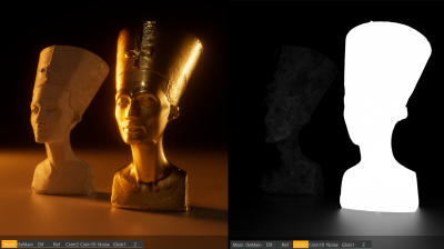

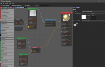

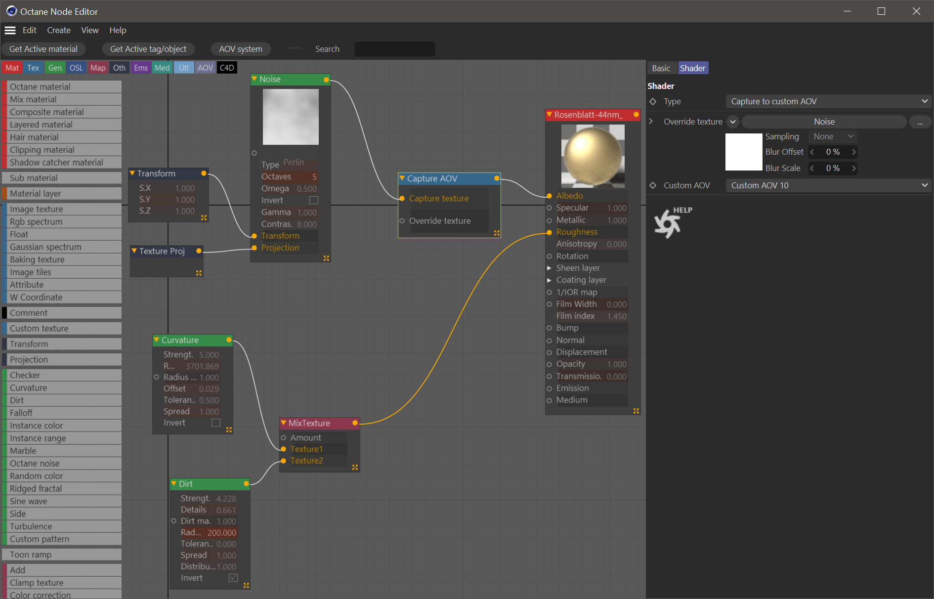

The image below shows the Capture AOV node in use:
In the nodegraph itself:

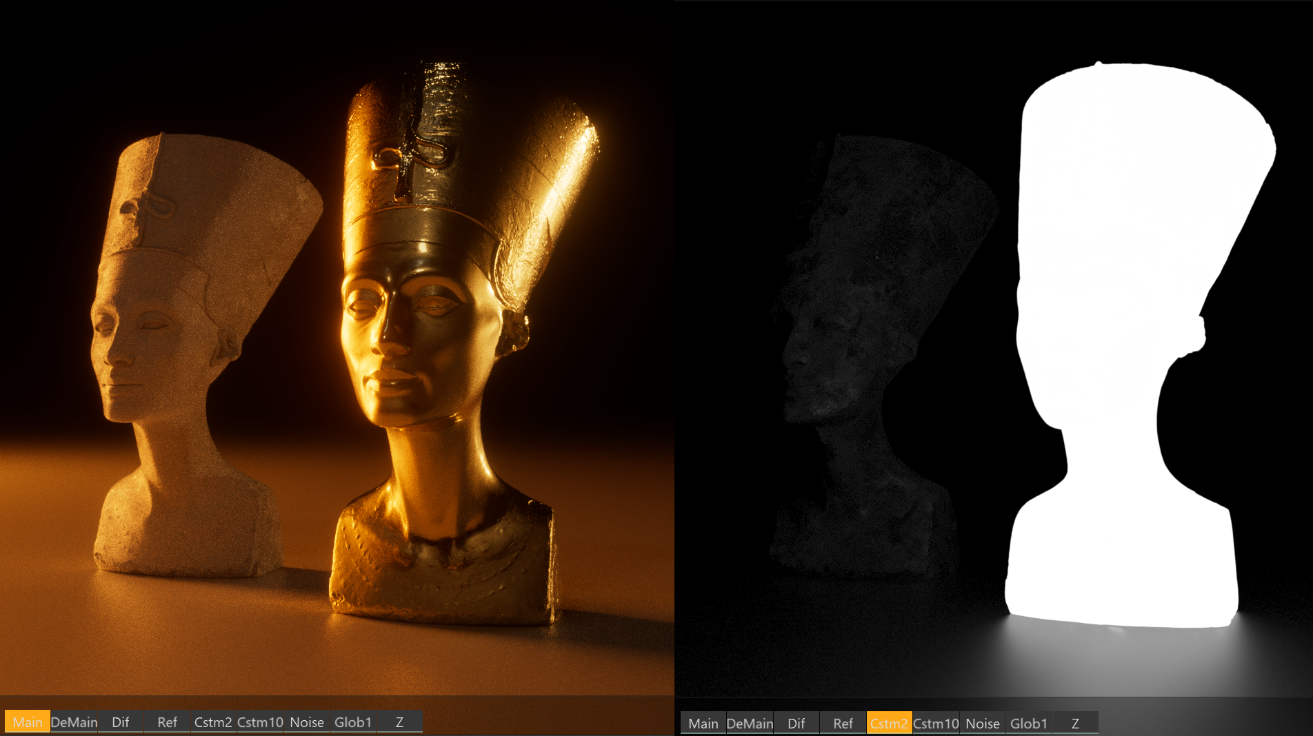

And this image is a possible result (main render on the left, output of the Custom AOV on the right):
