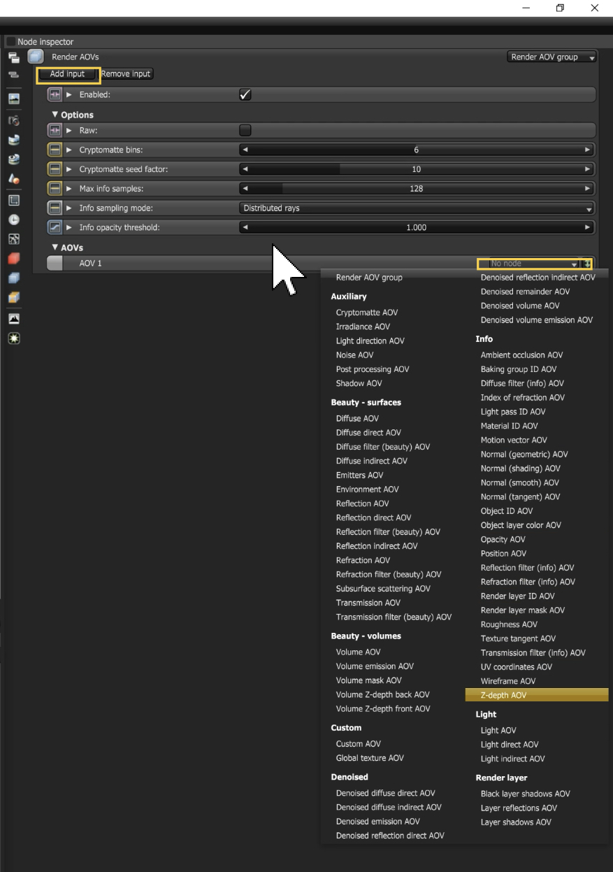

If you have switched from 2020.2.x to 2021.1.x, now the Z-depth pass is under Render AOVs/Render AOV group node, you need to click on the Add input button, then select the desired AOV in the No Node menu:
