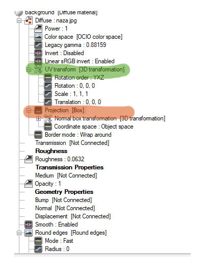

How do I fit a map to an object.
Should I be using the uv transform or the projection box controls.
Here im trying to put an image on a box in the background but the image rendered in the view port is different to the actual rendering.
The viewport shows that the actual images is not fitting the box background.
Also, shouldnt the map fit the box when the scale is 1,1,1 and its fit as a box map.

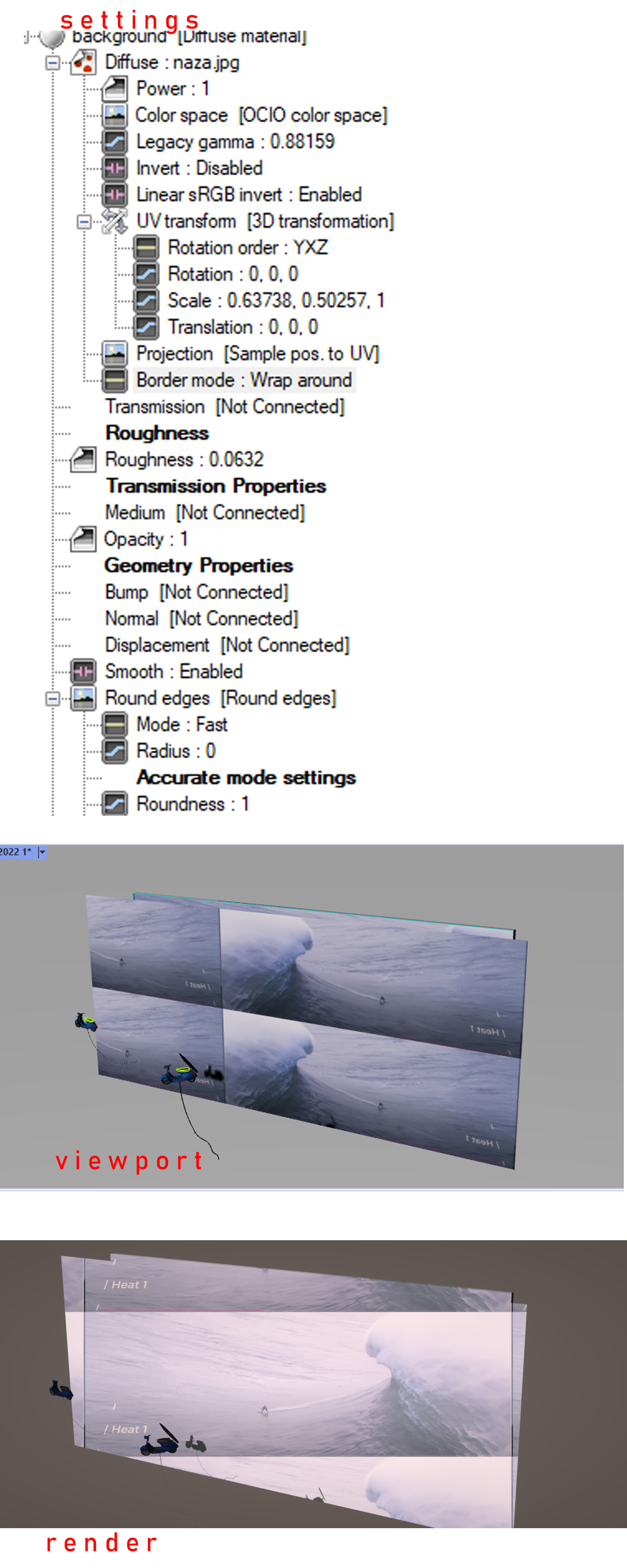

Now what the F..k is happening???
The viewport and render still dont match up but the map seems to be getting thrown onto the shape as if its flat packed.

If the UV's on the geometry (say a plane) are from 0,0 to 1,1, then the Image will automatically fit. If your UV's go 0,0 to 0.5, 0.5, then you will need to scale the image map by 50% to get it to fit. I would not recommend box mapping, just use the default Mesh UV projection. For example....How do I fit a map to an object.
Rhino->New Scene->Surface->Plane->Corner to Corner
Add an Octane Material and assign it to the plane
Change the "diffuse" pin to an RGB Image and select an image
The image will automatically stretch to the extend of the plane, since the plane has UV coordinates from 0,0 to 1,1.
If you even want to see the UV mapping for an object, open the Octane Viewport, and enable the "UV Coordinates AOV" (Click Add on the Render AOVs node in the Rendertarget and set the "AOV 1" node type to "UV Coordinates AOV"), then select "UV Coordinates" from the combobox in the toolbar of the Octane Viewport. Black = 0,0, and yellow = 1,1.
You can also view the UV's in the Rhino Viewport via the Rhino Options->View->Display Modes->Shaded->Objects->Surfaces->Surface Isocurve Settings->Isocurve color usage->"Use specified UV colors" and assign the U and V Color.
