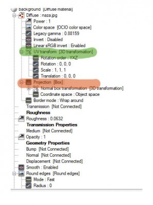

How do I fit a map to an object.
Should I be using the uv transform or the projection box controls.
material panel
material panel

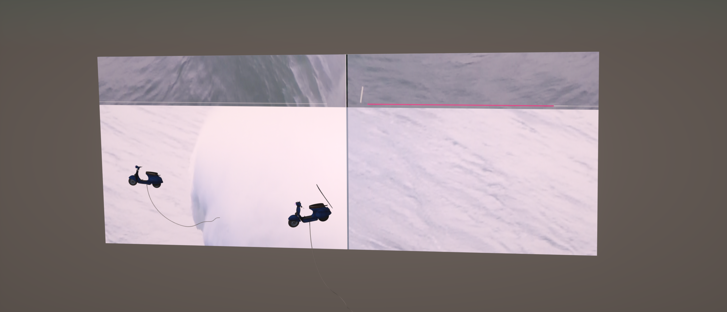

Here im trying to put an image on a box in the background but the image rendered in the view port is different to the actual rendering.

The viewport shows that the actual images is not fitting the box background.
viewport
viewport
Also, shouldnt the map fit the box when the scale is 1,1,1 and its fit as a box map.

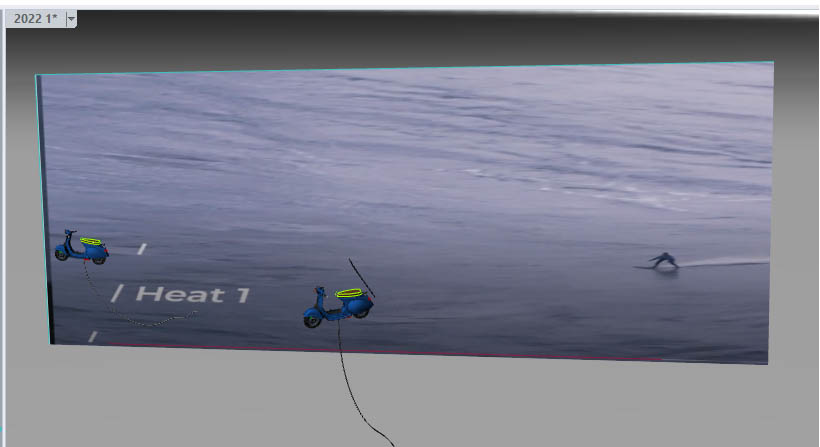

And now here is the rendered image i get back which is different again.
actual rendered image different to original and viewport

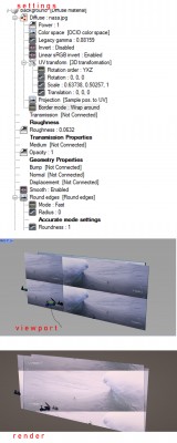

Now what the F..k is happening???
The viewport and render still dont match up but the map seems to be getting thrown onto the shape as if its flat packed.
