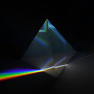

First here is my "master" reference created with Mantra, you can see there is some light scattering within the prism so its not completely black and there is indirect light bounce back onto the ground plane as well. To achieve this in Mantra I'm using 2 indirect lights "Caustic Photon Map" + "Indirect Global Photon Map" with the PBR render settings on "All Paths" vs the default "Specular, Diffuse Paths". Render time about 55s

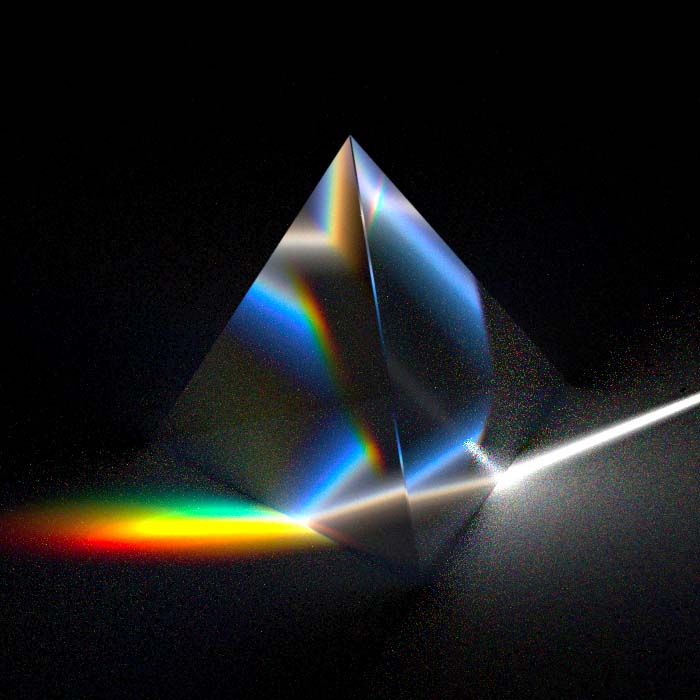

The redshift result isn't bad, but prism is very dark, the bounce light onto the ground plane is working well though, here there is more noise than the mantra render and the render time was slightly higher at about 70s

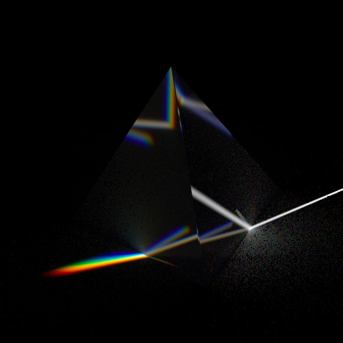

Now onto Octane, this first result is with bounce settings matching Mantra, diffuse depth of 2 and specular of 6, at 2000 samples it rendered in 19s. But the scattering within the prism is missing and there is no diffuse bounce on the ground plane.

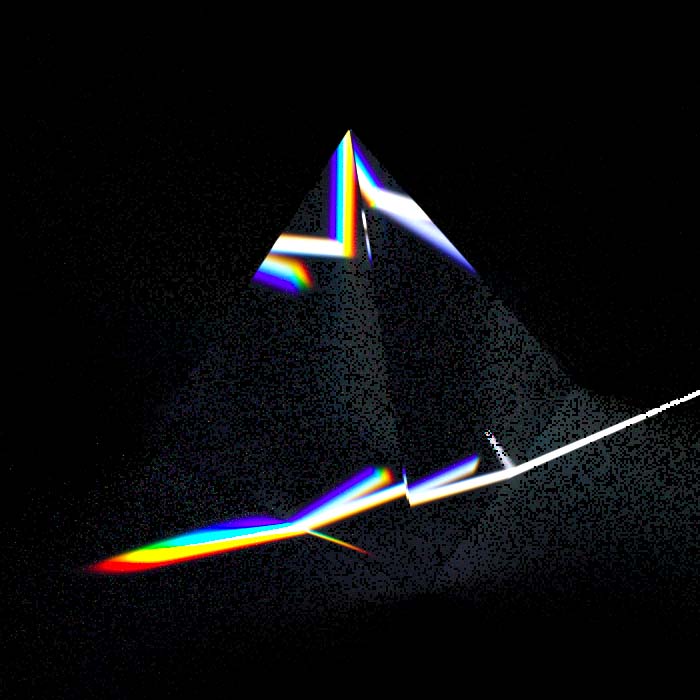

I tried increasing all the bounce settings along with a 10x increase to the light strength and you can see there are photons bouncing around there but after 10 minuets rendering this is the result I got, its very noisy and still far from my reference

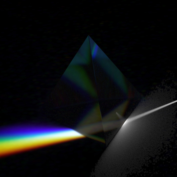

After more tweaking of coat/sheen and their roughness values, I did finally find the look! (added an extra light too with a wider cone angle). I did find playing with these settings enough (and this applies to RS as well) ends up giving a result like the one I got from Mantra (that didn't have any coat/sheen). Still not sure why there is this shader difference, but happy with the results :)
This is with 4000 samples at a render time of 73s, which puts it roughly inline with mantra/rs in render time, but I'm really liking the look/qualities of this! Just need the denoise filter enabled for Photon tracing now :D
