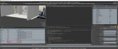

Hello,
I tried to use the render pass script but
it doesn't work. A little windows popup with the progress of the rendering but rendering doesn't start.
I never used scripting in Modo so I can do something wrong.
Anyhow here is a screenshot.
There is an error about c++...
I think that incorporating render pass is crucialin the Modo plugi it will save lot of time.
I have ot render 5 different cameras in a scene plus object on and off and if render pass will work
this will save me lot of time rather than waking up in hte night to change manually the render pass...

spigolo wrote:Hello,
Which script did you use please? (a forum post link would help).
What version of Modo and the Octane plugin are you running please?
Paul

Hi
i used the one provided by you in the script forum:
viewtopic.php?f=34&t=78755#p407291
Im not very expert of scripting , now at home I created a very simple scene
and I removed any path saving from the kernel animation settings and I put the pathfile name in hte script and it worked but only renders a single frame not all the frames of the animation...

face_off
Posts: 15829
Location: Adelaide, Australia
That script only renders a single frame, not an animation. The script could be enhanced to render out animations (although would most probably need some minor modifications to the plugin).
