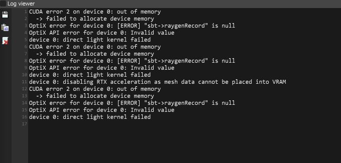

This is the message I get...

spigolo wrote:This is the message I get...
It is definitely saying you are running out of VRAM. Perhaps you have another application using VRAM? I suggest sending this screenshot to OTOY via the Support menu option at the top of this page, and they can give you more details on the cause.

Hi Paul thanks,
there was a lyer of the object that is the problem...
If I keep it off everything works...
