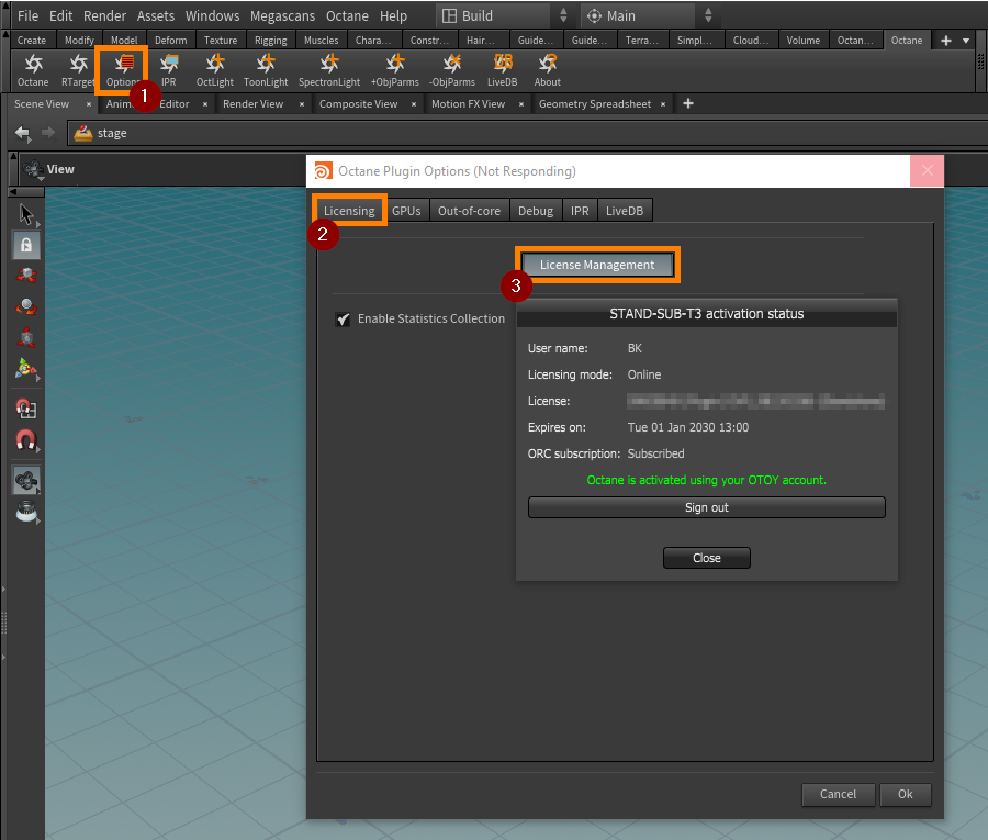

Hello there,
It sounds like the crash is happening due to license activation. Octane Solaris license can be activated from the main plugin shelves!
Please try the steps and let us know if Octane still crashes!!
cheers
Kind Regards
bk3d

Hi BK,
Thanks for the suggestion. I followed your advice step by step. Octane has been activated for the plugin, but the same issue persists within Solaris, i.e. I click on Octane to activate it as the viewport renderer and then nothing happens, while the option to use Octane disappears from the dropdown menu. Have a look at the screen recording below:
Octane_SolarisIssue.mp4
(5.97 MiB) Downloaded 3484 times
I wouldn't even say that Octane "crashes" because the normal Octane IPR still works flawlessly, even after the viewport render option has disappeared.
Any idea what's going wrong?
