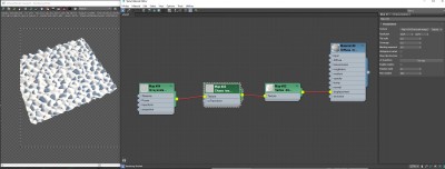

I've got question - if is possible to randomize Displace using OSL Texture?
paride4331
Posts: 3998
Hi kcpr-raffaEl,
You can do it using the Chaos texture node.
Regards
Paride
kcpr-raffaEl
Posts: 136
Joined: Thu Aug 14, 2014 12:10 pm
Thank You for your answer!
I should be more precise:
I need every instance of object to have different displacement, but based on one texture, which position coordinates and rotation are randomized by OSL Script.
I'm not sure if it's even possible... :?:
jobigoud
Posts: 257
Joined: Sat Aug 15, 2015 1:28 pm
Per-instance displacement is not supported.
kcpr-raffaEl
Posts: 136
Thank You,
That makes everything clear.
